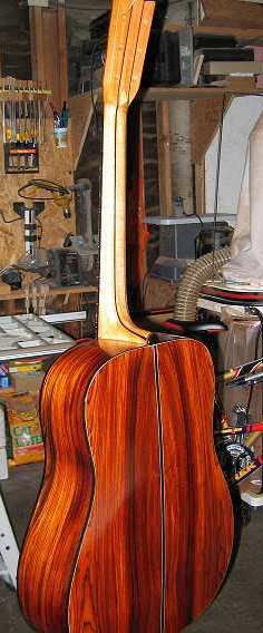

I spent my weekend putting the last coats of laquer on a couple guitars. Starting with the "lesser boast," here's a couple pics of a dread I've been making with cocobolo back and sides, Englemann top, ebony binding, with a vine inlay on the fingerboard.

Both of the guitars have "racing stripes" on the neck --- the first was ebony, and Jeremy's is Padauk to match the back and sides.
One of the most exciting things about the weekend was that this is the first time I sprayed laquer and had the finish go on just about perfect. Usually, I get boatloads of orange peel and end up sanding for days to level. But these guitars have absolutely no orange peel on them. I'm actually looking forward to sanding, because it shouldn't take long. (Well, not really, but it'll be a lot less work than in the past.)

Kelby, both of the guitars really look nice. I'd say you have plenty to boast about. I really like the racing stripes on the necks and in particular the way it looks on the heel of your sons guitar. Kudos for including him in your building.

Absolutely, both look great, you must be very proud of your boy.
Love the blue bridge! I would leave it like that!

Beautiful! My oldest daughter is showing signs of wanting to "do what daddy does" in the shop. Shes 7 now, I hope one day she too will do like your son.
BTW, I love the streaked top.. Thats Engelmann?

Really nice guitars Kelby. Please offer my praise to your son as well. That's quite an accomplishment, even if dad helped a bit. Please stop by our table at HB and introduce yourself. I would love to meet you both.
