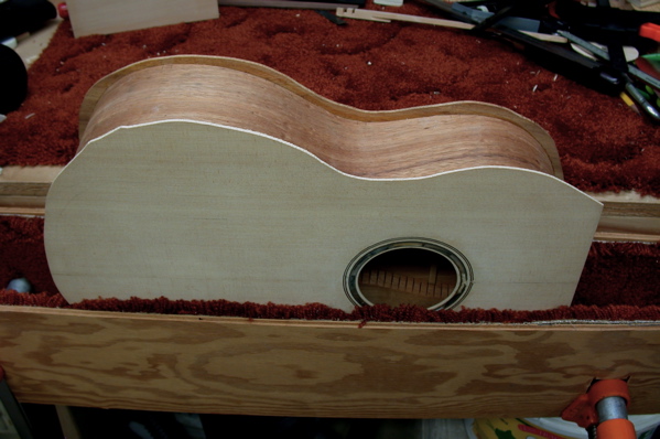

Seems like Mike is correct about the bending the binding. I would want to bend the binding in two axes instead of just one like we ususally do.
I use a jig modelled after Arnt's (with two bearings) with a vise of sorts from Sylvan Wells' web site. In case anyone's wondering, the plates were routed flush before routing the rabbets for the binding.
