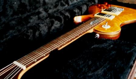

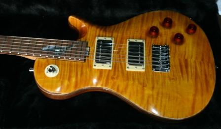

I have finally finished my first two electrics that I have been building side by side for a good while now.  School got really busy, then I went to Europe and got married - anyway - they are done...

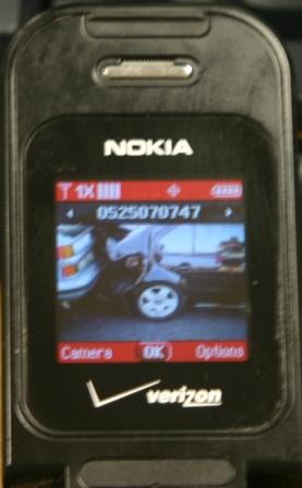

Then on my way to give them to guys I made them for, a Southern Ohian man with a 3/4 ton pickup decided he was going to try to thwart my plans and smash into the back of my little Vdub at 50 mph and send me straight into the Saturn Vue in front of me.  He suceeded in totalling my car-from both ends, smashing my trunk into the back seat, breaking windows, and interrupting my life  - however, despite his best efforts, these two electrics and my Breedlove Acoustic - all in the trunk, were not damaged.  The Breedlove was even in a gig bag...go figure.  I had to break the trunk hatch the rest of the way off to get to them.
What a blessing.

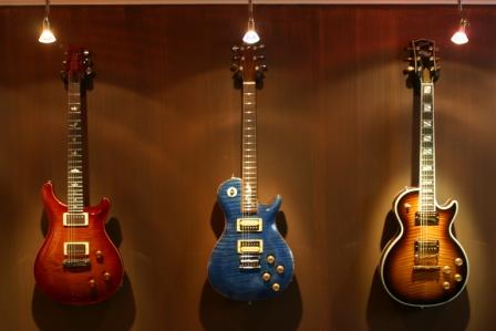

The body design was a blend of a PRS and a LES Paul...so this picture is interesting.  Essentially, all I can see for next time is to reduce the size of that blasted upper bout...it is a little bigger than I thought.

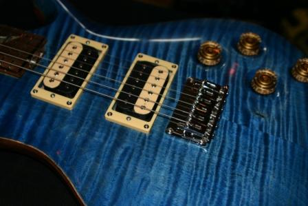

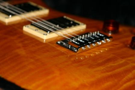

Nice Electric design...a very cool mix of LP and PRS...Did you do anything different as far as the electronics? At first glance it looks like the pickups are really close together which would limit the difference in string sound but I see that you have the p/u's reversed so it gives you more distance.

Shawn - honestly, when I first positioned the pickups, I knew no better...That will change in the guitars to come.  What I did with the wiring was a combination of a great many standard methods.  I made it possible to tap both pickups, which gives some good tonal variation.  Additionally, I added a small capacitor on the volume pots to bleed some of the treble off at the low volume end - so it would be more consistent across the volume board.  I also swapped volume - 3 way - tone connections to provide for individual volume control when both pickups are activated.  Aside from that, I work for a prototyping engineering firm, and we recently bought crate loads of a company's old stuff - in it were boxes of mixed up orange and green drop caps...so I experimented with them to better attenuate certain frequencies based on the pickup position...blah.  I had some fun and learned a great deal.
