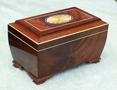

For my money, nothing captures the richness of mahogany (think 18th century museum pieces) like the traditional chemical treatment of dilute potassium dichromate solution. I've used it on reproduction furniture for years (typically under FP). This jewellry box gives you some idea.
It is not a stain so it doesn't mask anything. (looks like orange Koolaid & reacts with the tannins in the wood to bring classic red/brown). Water based, doesn't blotch, easy to use/adjust, POISON!!!!

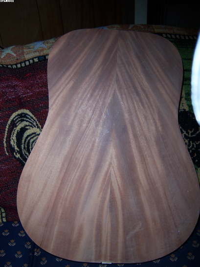

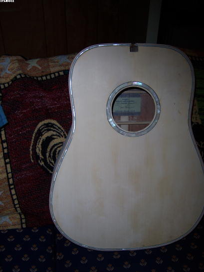

By the way, here is what I am working on... I only have one side of the bling in right now, so I am still working on it... You can see the figure to the wood though
PostPosted: Thu Jul 05, 2007 2:14 pm
Man oh man, that's going to be beautiful.
The top is very David Russell Young-ish in its look.
He was my first real inspiration on steel strings.
Keep us posted for sure!

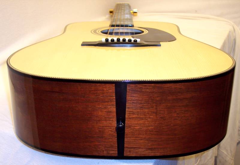

PostPosted: Fri Jul 06, 2007 2:08 pm
Posts: 805
First name: Jim Howell
This is an example of using Minwax Red Mahogany stain on mahogany --
Jim Howell
