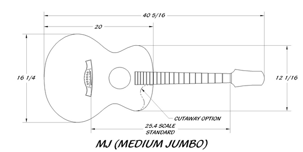

OK I have the MJ plans ready to submit to Lance for inclusion in the library of plans. I am going to proof them tonight and email them to Lance in the morning. It may take a few days or so for Lance to get them up on the site but they are ready to submit. I think you will like this one
This is not the plans

Nice, Michael. Thanks for such a fine design and for your time in making the plans available.
What is the history behind this model? Also...what is the specified body depth? TIA.

Sweet! Thanks so much Michael!
What a great addition!
