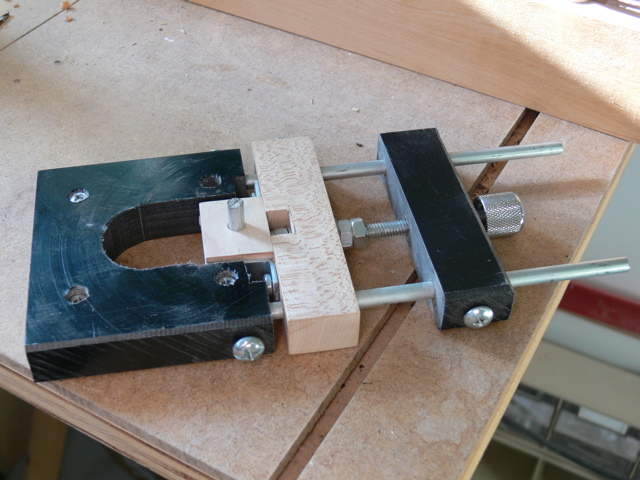

But I agree with the others here. I've used both, and the jig with a laminate trimmer is a far safer, more predictable way to go. Here's a couple of links that give you an idea of what's involved if you're inclined to build the Wells/Karol type. It can be done cheaply in an afternoon.
Sylvan Wells' site
My site
PostPosted: Wed Jul 04, 2007 1:47 am
Posts: 1012
Here's my version of the jig.  A word of warning when working with UML - its squirrelly that is drill bits have a habit of wandering so I ended up using some hardwood instead.  If I had it to do over again I'd make it all in hardwood.  I use this jig for rosette cutting and the fly cutter for cutting out the sound hole.  You can also get the fly cutter from Lee Valley.

Thanks everyone for taking the time to respond. Ok, I'm convinced, I'll get a Laminate trimmer. All you have to do is mention saftey, and you have my full attention.
<b>Todd wrote:FWIW, the Wells/Karol jig, a decent laminate trimmer, and a 1/16" and 1/8" bit will pretty much cover anything you'll do on a rosette - the cut is very clean and you get micrometer adjustment for channel positioning.</b>
Todd (or anyone else) could you recommmend "a decent laminate trimmer"? Happy 4th everyone!

I googled the The Wells/Karol jig and got nothing. Can someone tell me more about It, and where to get it? Do I have to make It? I hope not. Are there any circle cutting jigs that i can buy that will work on the PC310? Thanks for all the help
PostPosted: Thu Jul 05, 2007 1:38 pm
look 5 posts up; todd stock posted a picture of it!
