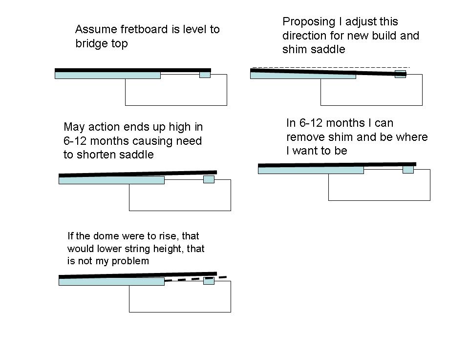

Well I am might confused now so let me take another crack at it. First, to clarify - I am using a straightedge across the lenght of an unfretted fret board and at the bridge I am usuall about dead even with the top of the bridge (past approach). Months down the road after all was working fine, the action gets higher on me and I end up shaving down the saddle to restore the action to my liking (around .90 - .10 at the 12th fret). In some cases, this has resulted in a lower than desired saddle which does impact the volume.
Based on some of the comments, I think you guys are saying it is normal for the bridge area to belly up a bit which is natural and some say the sign of a good build. If that were to happen, it seems my action would be getting lower not higher.
I was thinking instead that my neck was pulling up which would cause higher string action and as the neck seems to be good an level with the proper relief I thought by setting the neck so the level was slightly under the edge of the bridge would result in super low action, requiring me to shim the saddle for the initial stages of aging, and then as the neck pulled up a bit I would remove the shim or shorten the height of the higher than normal saddle.
Her is a really rough sketch of what I am explaining. This wouldn't be the first time I have had brain block when it comes to seemingly simple concepts of the build process. Wondering if I am doing something more fundamentally wrong in building my necks (too light for exampe) or if I am just not paying enough attention to the neck alignment in the first place.
Rich-
I'm definitely not 'on the same page' with your analysis. If the top rises (bellies up) the bridge and saddle will move 'up'- further away from the plane of the fingerboard, and the distance between the stings and fingerboard will increase.
If the fingerboard is still fairly straight a month or so after stringing up, and the action is higher, then I'd focus on changes in bridge position when reaching a diagnosis. If the neck is changing shape, then the fingerboard will reflect the change- either by increased curve or by showing a definite 'change in direction' where the neck meets the body.
Anyway, I think the problem is mostly with language here- your idea of doing a 'pre-correction' is pretty commonly done.

I love you guys
I can't believe I missed this. Of course as the belly rises so would the strings causing high action at the 12th. I feel like a real dumb s__t right now and should know better. Anyways, I think I got the idea now and also reviwing that post Hesh so thanks to all of you for chiming in and helping me get this through my thick skull.
