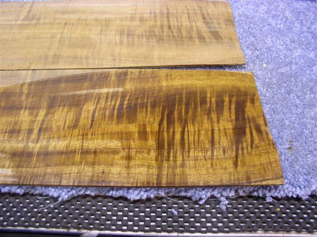

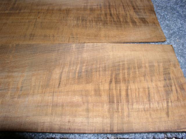

I am having a heck of a time trying to sand some flamed Koa sides. I have sent them through my sander, slow, fast, at an angle, stright in, super light passes, heaver passes, 80 grit and 100 grit, and every time, the "flames" in the Koa appear to darken. I had the same trouble with the back set too, but I was able to run the back through the sander at a 90* angle to the flame, and that fix the problem. The sides are too long to do that.
Any ideas?

Hesh, here is how it looks.

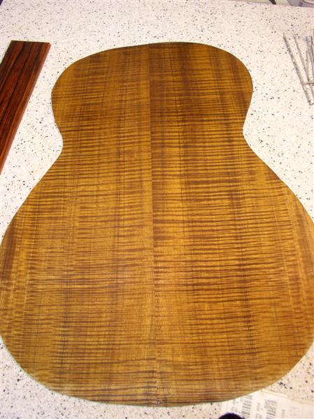

Here is how the back came out.
Peter, I dont recall seeing this on your guitar?

Lance, your sides look normal to me. The back is cut from a very different tighter fiddle back figure and your "dark" bands are there, but much narrower and deeper. The side grain undulations (what makes curl) are much broader and reflect back wider of course. Looks like you have some other broken curly figure going on also which might be causing the splotchy look, but it is "figure". Doesn't look like any of the wood is "scorched" at all.
