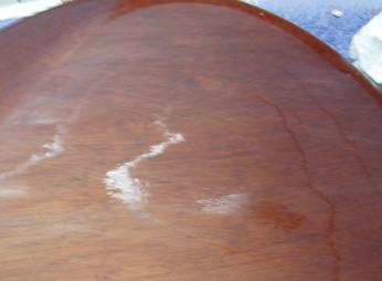

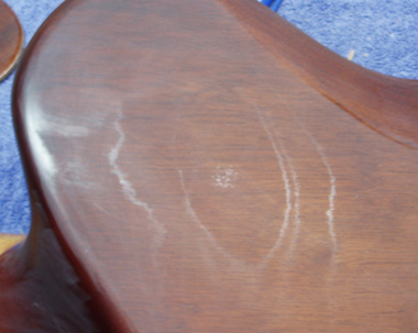

I've been spraying Target's USL waterbase lacquer on my latest electric,
and although I like it so far, I have run into a few problems.
I've had what appear to be witness lines, even though it's supposed to
have 100% burn in. I am pretty sure this is due to the fact that I sprayed a
few times when it was much hotter out than it should have been, and I let
it cure in my super-hot garage between coats. Has anyone else
experienced this? Could it be anything else?
Also, a warning to all who use USL: Do not use Novus #2 for final
polishing. It does something to react with the finish and leaves little
rings. #1 and #3 seem to be harmless however.
So, what do other USL users (if there are any here) use for hand polishing?
I buff out on the buffer with menzerna compounds, but I can't reach into
the cutaway so I need to hit that area by hand.

I use micromesh all the way through 12000 grit, then Macguires swirl remover and polish.  I am not sure why you got witness lines, but I have sprayed and cured in my second floor non-airconditioned shop where temps get over 100 degrees for curing (up to the high 80's when spraying) and haven't had any problems. The only issues I have ever had with it is by my own over-zelous sanding.    I live in upstate NY, and if I waited for perfect temps for finishing, all of my guitars would still be in the white.
Hopefully someone else will chime in with some answers as to what could have happened.

Thanks David. Maybe I'll give the micromesh a try. I did find something
on the Target forum about someone having problems using water as a
lubricant when rubbing out and getting witness-like lines. Glad to know
you've had success in the heat too.

Yes I have heard of water induced witness lines from using water as your sanding lube but have not seen them.
My only issue with target USL (same as StewMas Color tone) was the blue cast to the film. I have been using KTM9 for several years now. It has no noticeable blue cast and seem to me to burn in better, but I never had issues with USL burning in.
As far as a non water lube you could use K1 kerosene though it has some real fire hazord associated with it but works well.
I dont personally think you wuld have issues with distilled water and soap

I tried using water to wet sand on my first guitar and it made a mess of things.  I had pore filled and coated with 14 thin sprayed layers of USL.  It cured for 3 weeks before I started to finish sand.  My pore filling wasn't perfect and the water got to the wood causing the finish to check and crack.  I had to sand it all off and start over.  From that point on, I have dry sanded all of my guitars.  It is a bit more work, and the paper loads up more often but it is safe and works well.  I swear by the micromesh stuff.  It is expensive but it really works.  I can get 3 guitars out of one kit that Woodcraft sells and I dry sand with it.
Lots of people use Kerosene (clear) or mineral spirits to sand with.  I personally don't like using flammable and smelly stuff to sand with!

Michael and David, thanks for the tips. I'm not opposed to using
kerosene if it helps, but maybe I'll try distilled water first instead of tap.
I also picked up some Abralon sanding pads that I'm going to try, and
some micro mesh. Thanks again.

Mike...I used USL on 2 guitars and wet sanded using the standard water/soap solution. I used 320 through 12,000 MicroMesh.
How long after you sprayed did you start sanding? I wait 2-4 weeks with any finish and have never seen what you are showing. The longer wait provides that extra assurance that fhe finish is fully cured. IMO these finishes sand out much better the harder they are cured.
Also...like Michael...I abandoned this finish for the same blue cast reason. KTM-9 looks much better if you're going that route.

JJ, I waited just 1 week, but 3-4 days between spray sessions. I'll give these
latest coats a little longer to cure. Thanks for the tip.
