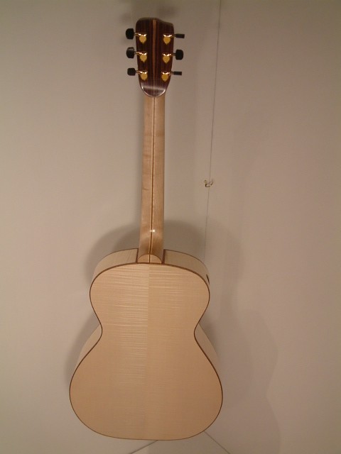

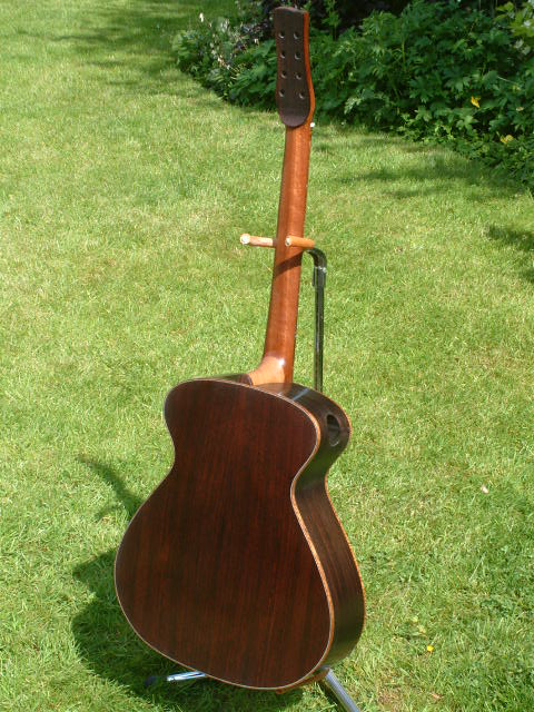

Andy,
Sycamore in North America is what we call plane - usually London plane in Europe. Sycamore here in Europe ususally refers to a variety of maple. Here's one neck I did with it:
Here's a Sapele neck with a London plane heel:
PostPosted: Mon Jul 09, 2007 6:35 am
Joined: Sun Jul 08, 2007 8:13 am
Posts: 34
Beautiful guitars Dave and thanks for the pics. They give a better idea of what these woods look like and to me they're both wonderful.
