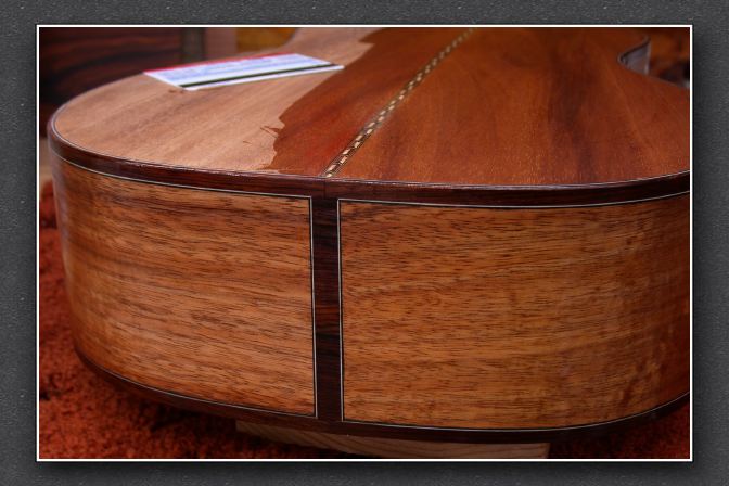

Here's mine. I've decided that I'm not going to mind. This Terz guit will stay in the family, at least for a generation, I hope. It bothers me less and less as time goes on.

The thing about mistakes is that they will always look worse to you than to others... Every guitar emds up with slight differences for many reasons and while they jump out at the builder every time you look at the guitar, usually most are so minor that unless pointed out are not picked up on by others.
Pat, good looking guitar...I really like a terz size guitar...one of my favorite to play. Nothing wrong at all with that guitar, its just that the grain didnt match but if it sounds good and the rest of the guitar is well made than it is a success...great example.
