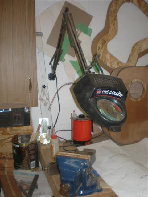

I have one of these little boom magnifiers. It was pretty inexpensive, I think under $20
I have it mounted close to my vise as you can see. That way it's right were I need it when doing inlay work.
