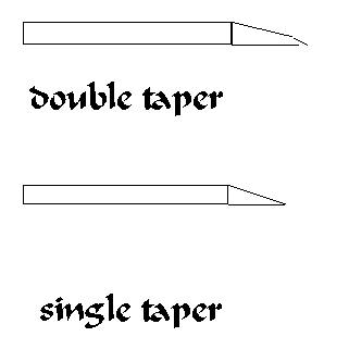

I'm not sure if my explanation was clear ont he forst post, but here is a picture of what I am talking about:

I have the powered version of the MK II and do the double taper. It's a simple thing with that machine. After you make the primary bevel, you just switch to a thinner plater and without adjusting the blade in the holder, just run the edge again and it puts on the secondary bevel.

the purpose of the double bevel is to provide a relief angel. whether on a chisel or plane it reduces friction and promote the curl making the cut with less force.
it also has the added benefit of making rehoning quicker as less metal has to be removed.
if you are using a honing guide it takes no more skill to do a double bevel than a single.
only the second, more inclined bevel on the edge needs be polished. this will get wider as you rehone over time. eventually, over time it will require the the primary bevel to be reground, and a new secondary cutting bevel honed on.
with skinny chisels you can make spacers that are the thickness of the blade and put one on either side to keep it upright and square.

I'm a big fan of secondary bevels, but I don't see the arguments about 'reduced friction' and 'chip formation'- perhaps somebody can help get this concept through my addled brain?
I think I'm confused about the distinction between the cutting angle-ie the angle of the 'wedge' shape at the cutting edge- and the various bevel systems. Admittedly, putting a secondary bevel on an edge increases the cutting angle, which may make the edge less fragile and reduce splitting.
Let's consider a typical smoothing plane with bevel-down blade. Since the chip is formed on the 'flat' side of the blade, not the side with the bevel, any chip formation (and 'friction') has nothing to do with the bevel side.
The same argument applies to chisels working 'bevel down', as Billy Thomas has indicated.
I've never experienced much difference in 'friction' when using a chisel bevel-up and bevel-down on the same wood.
I've always assumed that it's what happens in the first 0.1mm or so from the edge that mattered- that's where the cutting is happening. The rest of the tool only exists to support that small area of the edge.
