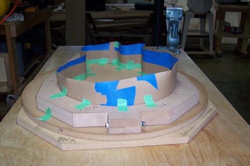

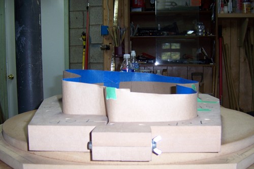

This is a paper profile of the sides ,Thanks to Colin and his tutorial of a wedge shaped guitar my nephew wants me to build for him.It`s sitting taped to the mold top side up with the back side down sitting on a
15 Ft. radius dish.The thing about it is,he is convinced that he wants me to wedge the top instead of the back.Which I`m not sure if this has been done ,or can be done properly.The differance from lower bout treble to lower bout bass is 1 1/2 inch.Which looks huge to me.The top is radiused to 25 Ft and the neck will be laying on the top side to side wedge angle,which I think is going to be very difficult to play,because of the reach factor.Not to mention as Rick Turner has pointed out.It`s difficult enough to set a neck angle and fret work and set up on a normal guitar,without throwing this wedge top into the equation.Is this whole thing possible,or worth the effort? This being only my third guitar,I may be in over my head.I`m hoping some voices of experience will chime in here.And also anyone out thre that has built a top wedge or whatever it should be called.

Wedging the top is asking for all sorts of neck trouble; you'd need to mount the neck at an angle (left-to-right) to the sides, which curve away quite a bit, and/or alternately build the neck so the entire fingerboard surface is tilted relative to the fingerboard face. In short: wedge the back, forget about wedging the top. Your nephew's wrong.
I was under the impression that a 1" difference is fairly common, although perhaps a bit subtle depending on the size of the body (bigger the body, smaller it looks). Haven't decided on the wedge for my current jumbo build yet (1", 1.25", 1.5"), but the actual wedge process (prop in dish, mark bent sides, cut away excess, sand as per usual with dish) went smoothly for me on my second guitar (first one I wedged).

The way I see it, you have two options if you taper the top. The first is that you'll have the extension flush on the treble side and you'll have to shim the bass side. From the player's perspective, it will look like the extension is elevated like many classical guitars.
The other option is to "twist" the neck so that the finger board lies flat on the wedge. You'll have to figure out how the heal and the rest of the neck will fall into place. Lots of work on that one.
Or you could do the right option and wedge it from the back.

It's not going to make it easier to play. It will be the same, but next to impossible to build. You are going to have neck alignment issues that will indeed make you want to puke.
If you twist the neck, literally carve it so the headstock isn't crooked like you don't like, there will be a slight benefit of having the first few frets perpendicular with the floor and then start to angle as you go up. That would help a bit with not having to cock your wrist as much. But doing that would make me insane for sure.

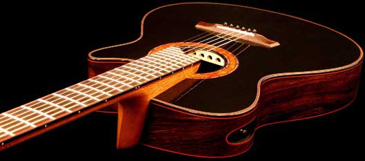

Just take a look at the Ergo guitar by Charles Fox. HERE. It has the wedge angled on the top and has a compensated neck twisting the other direction for easier playing (the fretboard doesn't have to be elevated... that is for another reason).
I am not an expert but it looks like you're heading in the right direction with the geometry. Maybe it's inexperience, ignorance or just plain stupidity... but these types of puzzles don't scare me - they only make we want to try harder and figure it out. Why be timid with trying new things????

Rick ,he has made a styrofoam body that he seems real pleased with.Of course there isn`t any neck attached.I don`t see any serious problems with the body.I think the whole neck situation may get a bit hairy with a wedged top as compared to a wedged back where the neck alignment would basically be the same as any other guitar.So when you said "you`re doing it against your

Also (to essentially reply to myself), I think the Ergo is even more subtle/complex/elegant than it looks, with a wedge and a tilt and a twist and yet still having the strings all line up and sit in the right plane, the right place. I'd love to have the insight and chutzpah to design something that complex - and yet perfectly balanced in terms of aesthetics and design - but I fear I'll have to build a few (dozen/hundred) more, and possibly grow an extra creative brain extension.

[QUOTE=Mattia Valente]Also (to essentially reply to myself), I think the Ergo is even more subtle/complex/elegant than it looks, with a wedge and a tilt and a twist and yet still having the strings all line up and sit in the right plane, the right place. I'd love to have the insight and chutzpah to design something that complex - and yet perfectly balanced in terms of aesthetics and design - but I fear I'll have to build a few (dozen/hundred) more, and possibly grow an extra creative brain extension.[/QUOTE]
Yeah you are absolutely right in the fact that the ergo is far and away a whole new ballgame. The tilt down and to the side adds all kinds of strange predicaments that I can't even comprehend because I am not even that far along on my first build. I just used it as an example because what he was asking can be accomplished - and I don't think it would have to be done in the extreme fashion Charles Fox does it. My big thing is "what's the worst that can happen?"

    If you look at the Ergo, you see, the angle of the neck heel is, in reality, perpendicular too the top!
    Further examination shows, the bridge to be parallel to the top also. It's more of an optical illusion, or wishful thinking to say the top is wedged.
   On consideration, this would require the bridge be substantially thicker on the bass side of the bridge. Now this may or may not be advantagous, but it is definitely an unknown factor! It also brings up all kinds of points about bridge heights and tone affect.

I like your mock up but I’m not seeing much of a problem. The back, soundboard, bridge, bracing, fingerboard are all normal like any other guitar. The sides profile appears to be different but is essentially normal. The tail block would only need to have the top angled to match the soundboard angle. That only leaves us with the neck and the neck block as having any real difference from a normal guitar. I’m still not seeing much of a problem. Keep your neck normal like any other neck aside from adjusting a bit at the bottom to match the back plane. After all, the neck will be placed on a normal plane with the soundboard and bridge. So as I see it, the only real alteration of the guitar would come at the neck block. Design the neck block to receive the neck at the desired angle to match the soundboard angle. Maybe make the block a tad larger or some carbon fiber for extra support. Is my understanding that this area in not really producing any sound so you should have room to work with the neck block. Anyway, these are my thoughts.
