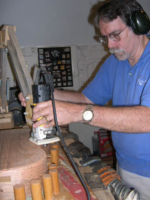

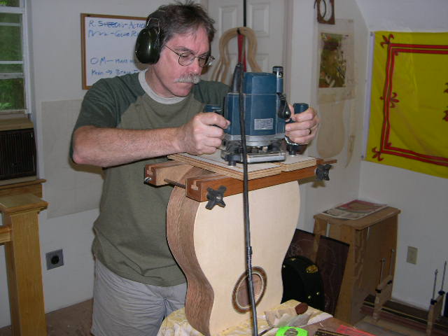

I've been sluggish of late posting these shots, but here's a few more counstruction scenes. I don't remember where we left off, so let me start with routing for the tail wedge:

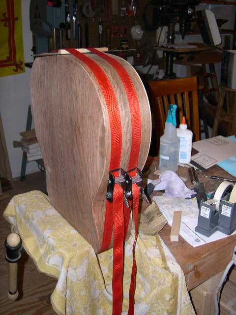

Next would be the band clamps gluing the wedge in place:

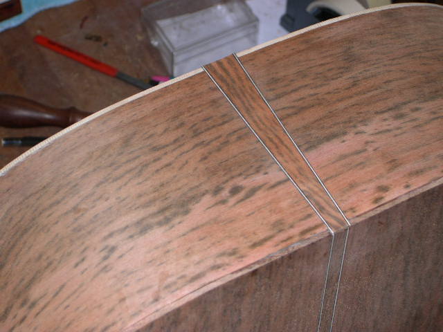

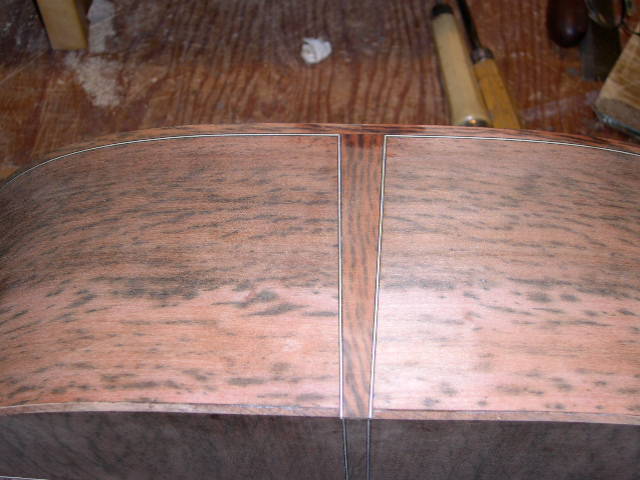

Then, a view of the wedge in place and scraped down:
One of attacking the box with the binding jig/router:

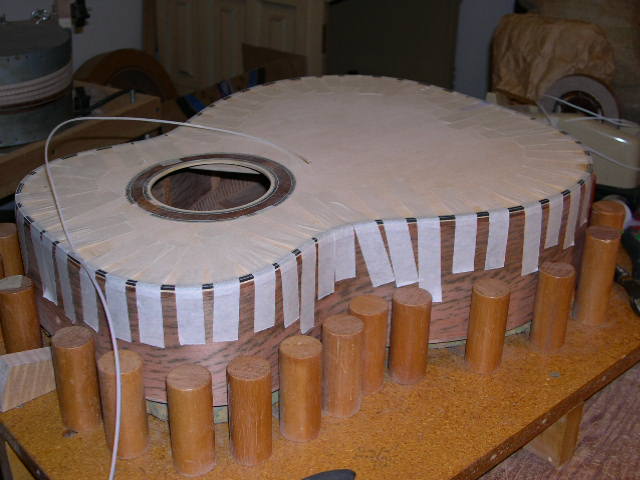

Next, a shot of applying the purfling/teflon strips:

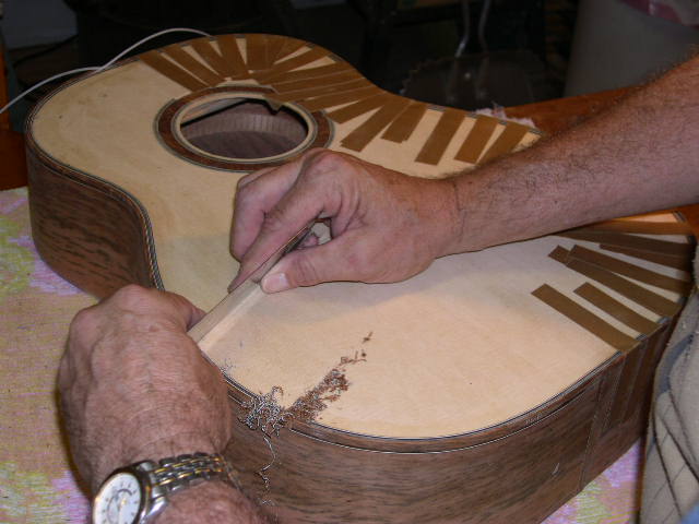

Scraping down the entire sandwich:
And a shot of the top binding atop the wedge and the intersections of the miters:
Sorry for the # of picts. If you've made it this far, thanks for looking. Hope you enjoy these shots of Tim's amazing Tas Tiger Myrtle. I'm enjoying building with it for sure!

Dang Steve I have been trying to figure a way to put in end grafts after the box was closed and could not figure a safe clamping process. Brillant simply brilliant

   Looks like the moon was full when you started to cut the binding. I notice facial hair it poping out. Care to show us your canine teeth. (or maybe more time has passed between shots than it seems)
   I like that binding cutter.

Beauteeful work Steve. I like your end wedge router jig !
And the band clamping is a great idea too! Got to get some of that Tiger Myrtle!

Michael, if you are like me, then you also prefer to put the wedge in at this stage. If the top or back are off center just a wee bit then this can help to take up the slack. (There--I've just exposed a "merely-mortal" problem...of which I have plenty.)
Bro--indeed, cutting the binding channel is a hairy experience, but in fact, much time has elapsed between the first and subsequent shots. Vacations are great times not to shave, and those whiskers are the result of good English cuisine paired with some old-fashioned American sloth.

Just one thing Steve, do you think that router is big enough or the job?

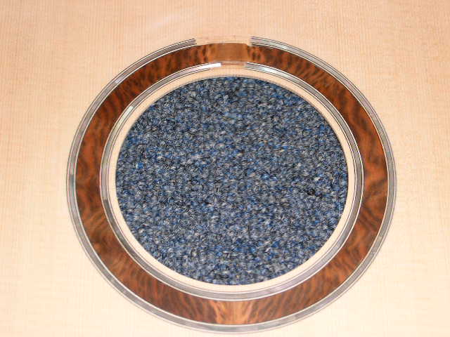

Is the rosette material tiger myrtle too?

Lance, it seems like a safe bet binding the guitar with the same material, doesn't it? However it isn't always, so it's good to hear that others appreciate the look.
Colin, if this turns out to be a Kinnaird then, well, so be it. I was hoping it would turn out to be a J. French, but I'm not that good a builder yet. (One can hope though....) Again, as for binding the guitar w/ more Tas. Tiger Myrtle, I asked Tim to supply some strips that were slightly different than the back and sides, and he REALLY came through. And the nice thing about it is that every strip is alike. Don't know how he did that.
Sam, thanks amiga, and yes, the rosette is the same stuff. And to prove that, let me post one more pic:
No, I haven't lined the guitar with indoor/outdoor carpet, as I have yet to see Alan weigh in on that technique. Rather, this is the unbraced top resting on one of the benches. It shows the t.myrtle bound with some pale red ab.

WOW!
That's probably the best rosette I have honestly seen on this site. The symmetry of that grain is breathtaking!!!!
