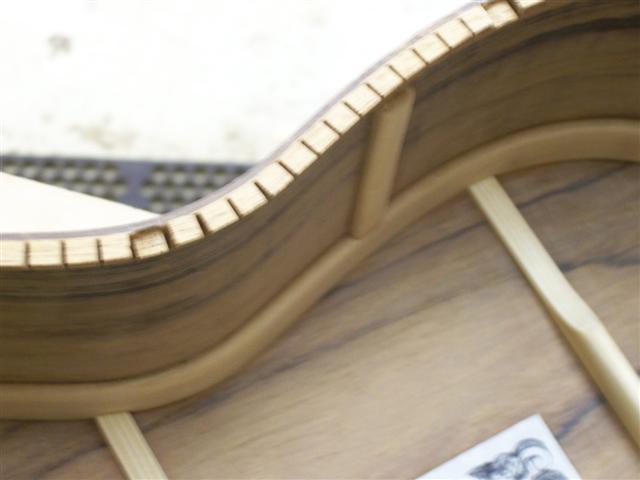

PostPosted: Fri Aug 17, 2007 12:54 pm
Posts: 2220
Robert,
Here are the pics of the one piece willow back linings-they are very close in color to the spruce back braces:
PostPosted: Fri Aug 17, 2007 11:19 pm
Posts: 499
Hi Brad, Thanks for the pics!
That’s some real nice work there!
The lining looks great, and I believe the color would go well in many cases. However, in this,
considering what I’m trying to do, I think I need to stay with something in a brown tone range.
Something that will complement the Pau Ferro.

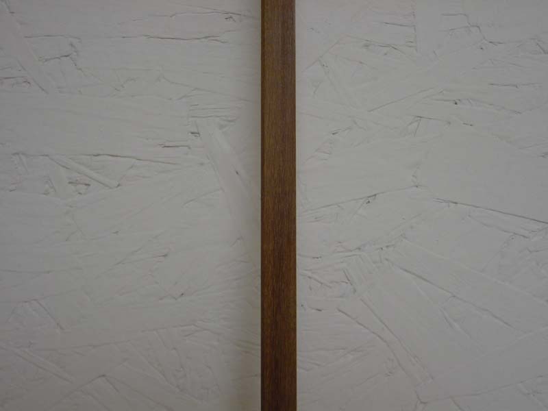

I just cut a piece wood yesterday, that I will test today. I have no idea what species it is. I bought
it about 4 years ago from an exotic wood supplier in Atlanta. I cut it to 5/16" X 9/16", and, I’m
thinking about soaking it in water, for maybe, 30 minutes or so, since it is so thick.
Here’s a pic of the piece!
