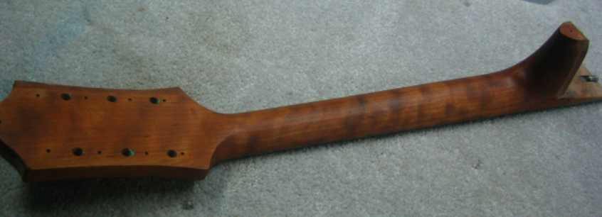

Posts: 2060
Here's a nice cherry neck from a '45 Epiphone I have in for restoration right
now. Nice color, no big pores, stiff, lighter than maple - as far as domestic
woods go, I give it my vote for best mahogany alternative, perhaps even
better in some respects.
