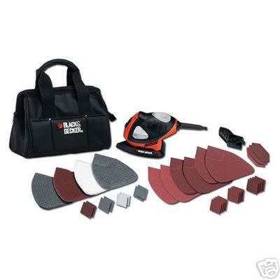

You will need a good sander.  I use the black and decker mouse sander like this:
The more I use this sander the happier I am with it. It can get into tight places that ordinary sanders cant even get close to. Buy the 3M sand paper for it. you will be wasting money on any other brand. The 3M outlasts anything else I have bought by 4 to 5 times.
