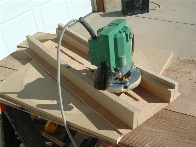

PostPosted: Thu Aug 16, 2007 6:12 am
Posts: 151
I use just a cheapie 3/4 inch rabbeting bit, which works well with the jig I made.  The dish blank is centered underneath on a dowel pin, with the "radiused rails" for the router to slide on straddling the dish on top.   Starting at the outer edge of the rails, once the bit touches the MDF, it wants to start spinning...in a big hurry, so be careful....but by the time I get to the center and take one slow pass back to the edge, it does a pretty good job.

I also use a 1/2" sprial upcut bit, which normally cuts a flat bottomed cut. But I use a "long compass" jig, and like jsimpson spin the dish blank on a center pin. A little work with an ROS after the router takes care of any small imperfections.
