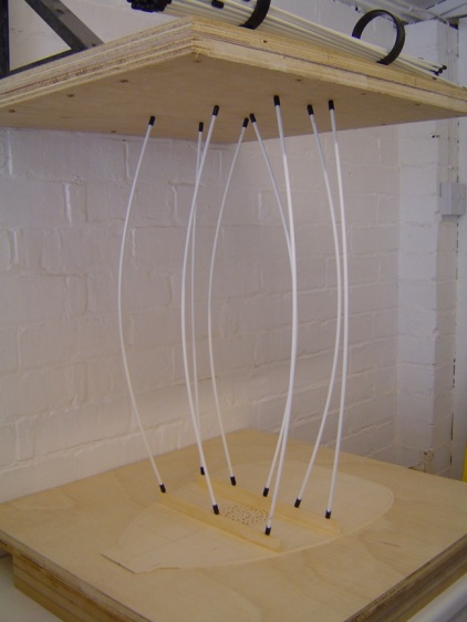

What all the others have said. Rock solid top, and rod flex of only about 1". My go bar set up uses 1 1/2" of plywood as the top that are fixed to very heavy 2" angle iron brackets bolted to a brick wall, no nothing moves!
I set the height of my top the thickness of my radius dish plus the depth of my guitar bodies and then reduce an inch. This means that when I glue on the top or back I have an inch flex in the rods. When bracing tops or backs I use a riser platform that the dish sits on.
I use 5mm fibreglass rods from the kite shop. Each rod gives a pressure of about 8lb so multiply that by 30 or so and you have a lot of force to contain.
This picture will show the sort of flex you need.
