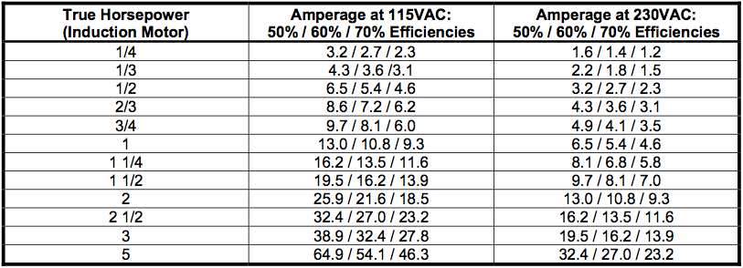

PostPosted: Sun Aug 19, 2007 6:53 pm
Posts: 2060
I found a good article on this subject.
http://
users.goldengate.net/~kbrady/motors.pdf
This chart (clipped from the article) is a good reference to keep on hand.
