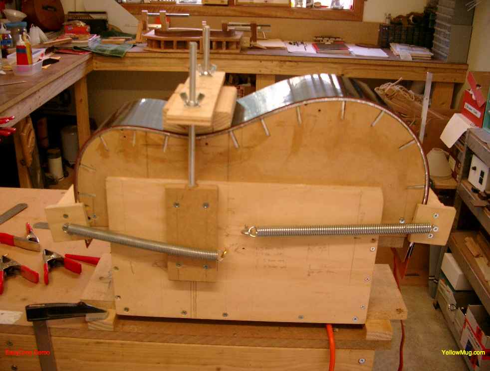

I received my thermal blanket from John Hall a few days back and today I got brave enough to fire the thing up and bend some IRW.
Man...what a different kettle of fish from slaving over a bending iron. After 5 minutes the wood was making the right noises and I cranked the waist caul down expecting to hear the heart breaking sound of cracking wood..but no the wood was as soft as putty. Down went the lower then upper bout cauls, blanket got switched off and I went for a cup of coffee. Total time taken to bend the side....about 10 minutes. Surely it cant be that easy.
Hesh...I sandwiched the wood, slats and blanket as per your tutorial and basically used your procedure with a few minutes added to heating times (upper slat wasnt sizzling after 3 minutes so gave it 5 mins). It all worked a treat.

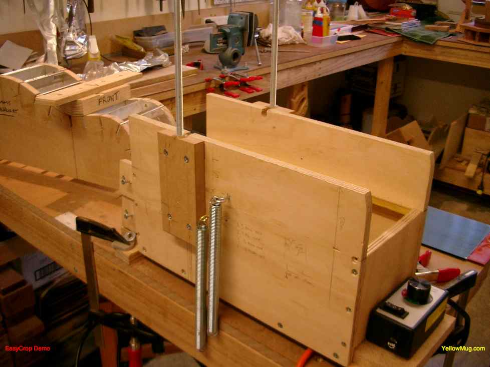

Bending forms and bending forms are all self made. I started with a fox style jig made using plans in Jim Williams' book but couldnt get the screw press to work properly and cut same off. The waist caul now runs on two threaded rods with wing nuts to apply pressure. A bit fiddly to keep straight but it works.

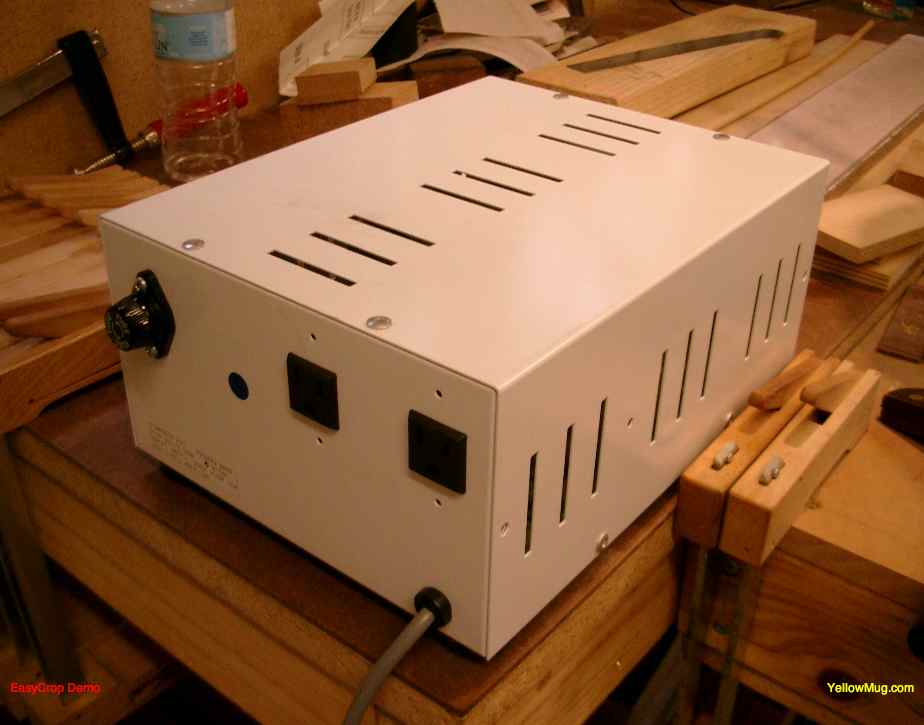

1. The blanket is an import from John Hall at Blues Creek Guitars. Im running it off a 1500 watt stepdown transformer which cost me $Aus385 from Tortec (http://tortech.com.au/index.php?productID=125)

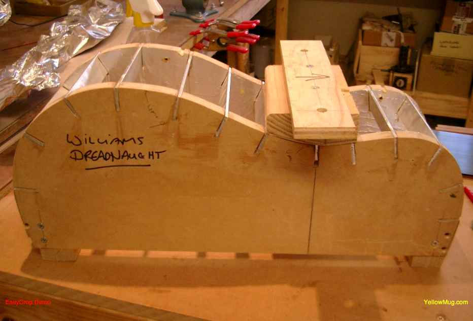

2. The moulds are made seperately from the bending jig so can be any shape you want. I make mine from 19mm MDF with aluminium spacer bars epoxied in.
3. for clamping the side use a wind down caul for the waist and cauls attached to springs for the upper and lower bouts.

I went for the 120 volt blanket because there dont seem to be alot of suppliers with 240 volt temp controllers/timers. I guess I could have found an appropriate router speed controller but couldnt be bothered. I have a couple of tools that also run off 120 volt so decided to get the transformer.

You're right about the lack of speed controllers Martin.
The only one I could find was a kit from Dick Smith.
I had originally ordered one from Timbecon but their suppliers in the States couldn't deliver.
The kit one works fine though.
