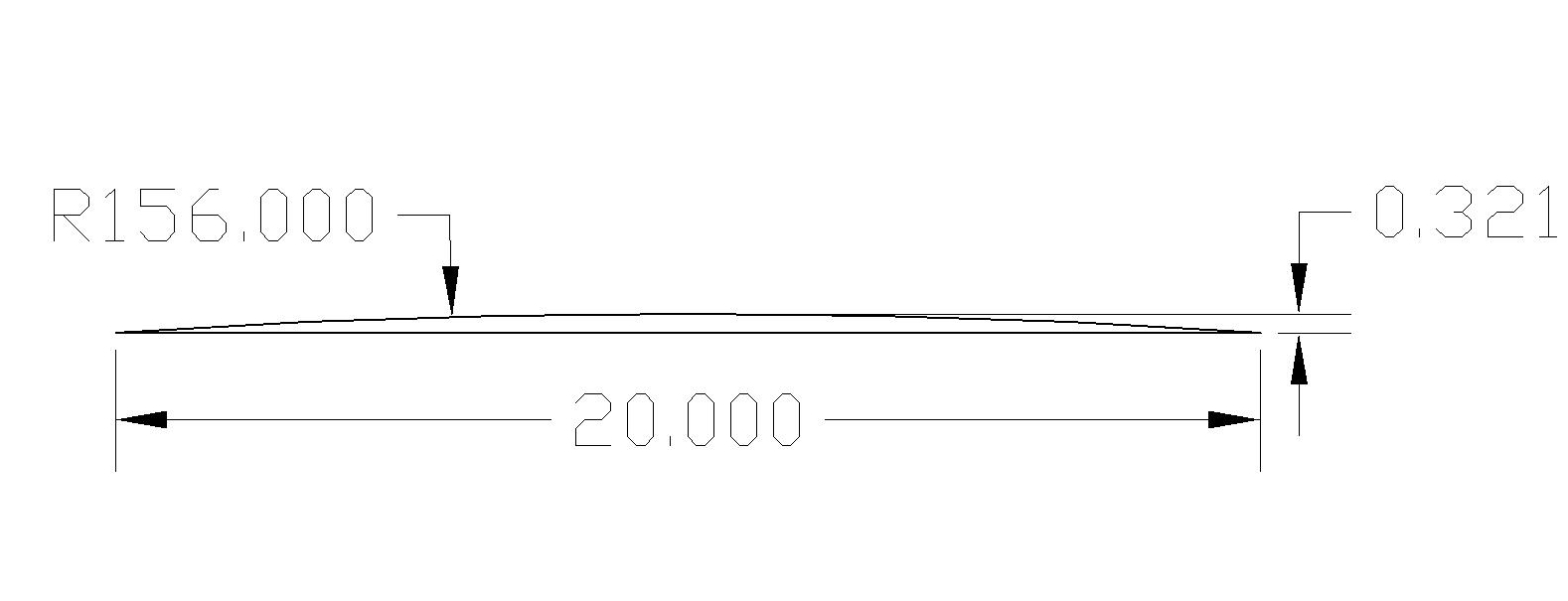

PostPosted: Wed Sep 19, 2007 5:33 am
Not that it is a problem but as compared to me you have very tall tops 26'(312") diameter dome would be 156" radius. over the length of a 20" cord (the nominal guitar body length.) that would be a .321" rise from the furthest perimeter to the center of the dome. That is nearly as much as my backs rise.

PostPosted: Wed Sep 19, 2007 5:47 am
Michael,
No wonder my right hand gets so dizzy when I play
It would be like your diagram IF I had 13' radiused braces just about everywhere on the top AND I used a 13' radius dish to sand the sides and fit the top . . . but I don't. It certainly does that laterally - but over a 16" arc (or 9-10" in the upper bout) it is not as dramatic. Length-ways, most of the "fall off" on my guitars happens from the back of the soundhole to the tail-block - which helps me with neck set and bridge geometry, plus the saddle is angled back slightly in relation to the plane of the strings.
