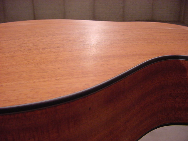

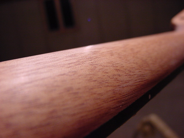

I thought I'd get a new thread going on the pore fill I have going on a mahogany/cedar guitar. I have applied two coats of epoxy and sanded between coats. The first coat was leveled with 400 grit wet paper. Took way too long and too messy. At Ricks suggestion I dug out the DA and cut it down with 500. I did the neck by hand so I could have better control of the cut and speed. It is looking very nice and I have no open pores, just nice level epoxy. Now I have this question for you seasoned West users. I have spots that I cut through to bare wood and wonder if I should spot apply, re-apply to the whole body or just seal the whole thing and spray clear. Rick? You here? Would the McF. rosewood sealer take care of these cut throughs? heres a shot of the leveled back and neck.

PostPosted: Mon Sep 17, 2007 12:07 pm
Posts: 1398
Cutting through doesn't seem to matter.   The McFadden sealer has the same wetting properties as the epoxy. I wouldn't bother going as fine as 500; use 280 or 320 and get the job done faster. That will also give a bit of mechanical bite for the sealer.
PostPosted: Mon Sep 17, 2007 12:28 pm
Posts: 404
Thanks Rick! That's just what I was concerned about, whether the sealer would wet the wood uniformly. I am surprised that we can get away with 320 or even 280! In automotive, the lowest we could go is 500 on a mechanical orbit, even then we had to be careful. I guess these epoxies and polyesters can actually fill the abrasions far better than the catalyzed urethanes. I like this West stuff!
I tell ya' what else. I LOVE the neck just in sanded epoxy alone! It feels very nice and playable. Thanks for the input too Hesh! Y'all rock!
PostPosted: Mon Sep 17, 2007 12:42 pm
Posts: 1398
With wood people tend to go to too fine a grit. You really shouldn't sand to any finer than 220 on wood unless you're going to do an oil finish.   The finer grits tend to burnish the wood and that prevents the finish from sticking well to it.   Between coats with poly (if I need to) you don't have to go any finer than 320.   I'm into being careful and working quickly.   The rougher grits don't load up as quickly, either.
PostPosted: Mon Sep 17, 2007 3:16 pm
Posts: 404
The wood was sanded to 220 but I did use the 500 on the epoxy. Didn't load the paper (3M gold) Seemed to sand quite fast, lots faster than the wet 400!
