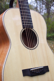

Lance, for what it's worth, I've made several guitars with tops made from the soundboards of old pianos. Some re-builds that are done to pianos require the soundboards to be replaced, so, often the piano doesn't need to be destroyed in order to harvest the spruce.
This is a Guitar I made a few years ago with a top from a 1918 Steinway Grand's soundboard.
The old piano soundboards are just spruce that's been spending the past 50 or 100 years creating piano music while it waits for one of us to turn it into a guitar.
And...the piano guitars have a really nice vibe because of all the built in history that comes with it.
