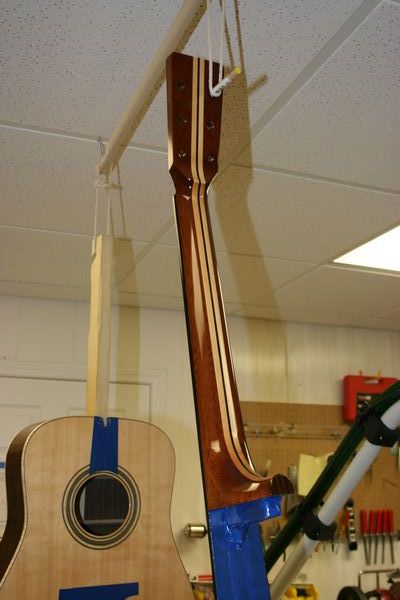

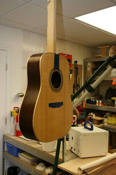

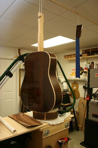

Here's my latest, an EIR/Lutz dread, with flame maple bindings. This one is for my son. Neck is a Watkins. The back has been sanded to 2000, but the sides have only been to 1500, and the top hasn't been touched since 600. I've been drop filling some gaps around the rosette - and I've been lazy. This is nitro, and I shot it using a friends Accuspray turbine. But he lives 1.5 hours away so driving is a bit inconvenient...so I bought my own. It's at the end of this post.
Here's the back of the dread.
Neck shot. Also not wet-sanded yet.

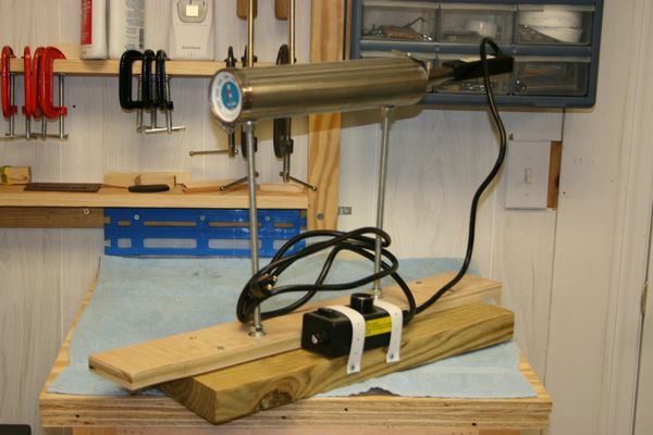

Based on ideas and recommendations from this forum, I hacked together a pipe bender today. I'm going to give binding the soundhole a shot, ala Woolson, and I didn't have one. The pipe is a 2.5" piece of scrap muffler cutoff that a local muffler shop let me have for free. The rest is exactly what was mentioned on this forum, a charcoal lighter, an oven thermometer and a piple clamp. Everything else was scrap. I tried it out earlier, and it works like a dream. Holds dead steady where I set it.

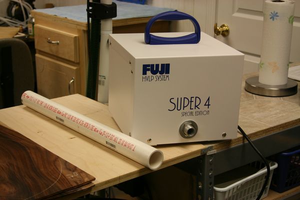

Here's a shot of the Fuji turbine. With the exception of the case color/design, and the amount of sound-proofing insulation, it's identical to the Fuji Q4 Pro. I've only sprayed water through it so far, for testing everything, but I'm elated with it.

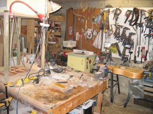

Hesh, you always seem to catch me at times when my shop is the messiest it can be.... oh well, I'll show you anyway... just dont mind all the sawdust on the floor.
First, here are a few of the guitars I am working on... from left to right,  Sycamore, Malaysian Ebony, Curly cherry, and flamed Oregon Myrtle. Also on the bench is the back to the flamed myrtle guitar that I am gluing the back strap on. On the right hand side of the picture, you can see some of my WAS stock on the shelf. On the floor next to the mold is a case of 50 Englemann spruce tops that came in recently from Canada. My bender is on a shelf by the window in the back of the shop.
Next is a picture of some sets of wood I will be swapping out at the next swap meet... different kinds of mahogany. Some of it is quite figured stuff. I have a lot of stuff to resaw in the next couple of weeks to get ready for the swap meet come to think of it.
Thats all I have to show you for now... lots of goodies coming in the next few weeks.

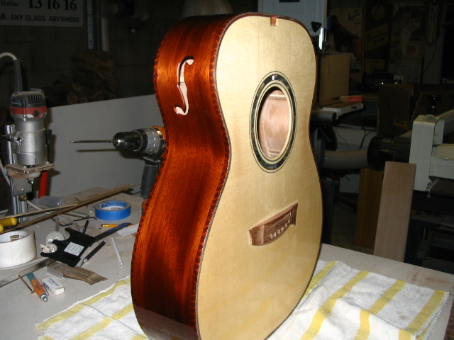

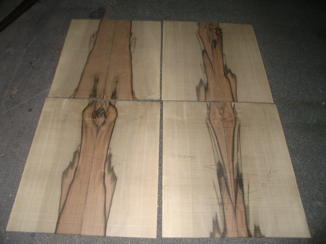

Did a heap of resawing over the weekend. Myrtle, Blackwood, Padauk, Curly Maple and some Blackheart Sassafras.

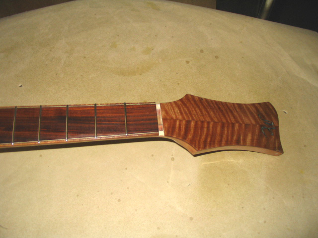

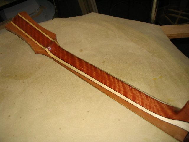

Here's the neck that's going on a Myrtle/Englemann OM that's heading back home to Tassie in a couple of weeks.
The fingerboard is Mulga from Tim Spittle.

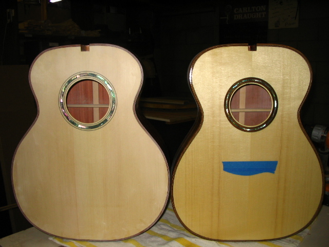

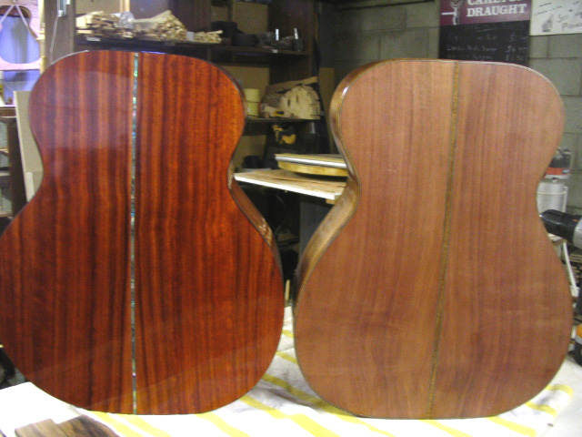

Here's the OM on the right. The one on the left is a Padauk/Adi 12 string which is one of our own shapes based on an SJ. The upper bout is quite small - just over 10".

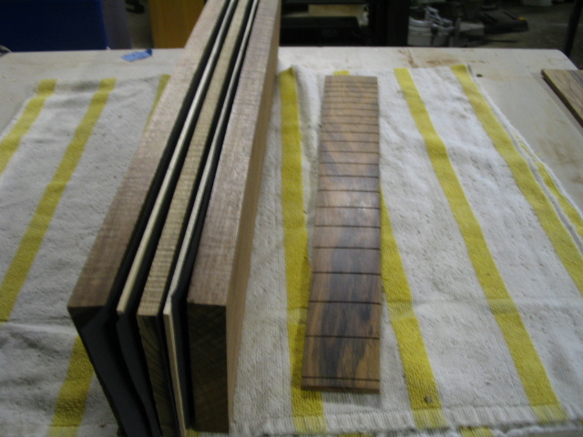

Here's the neck blank ready to be glued and a BRW fingerboard.

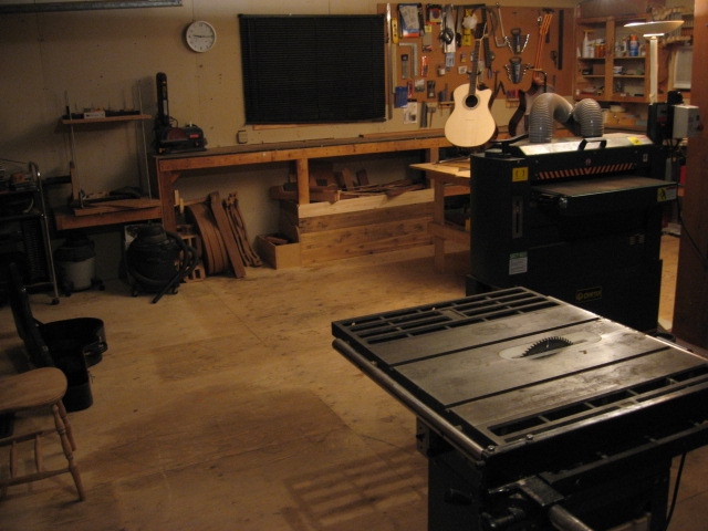

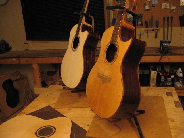

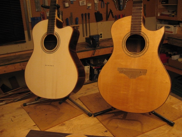

Well, since you ask so nicely!!!
As luck would have it, you caught me just as I've finished a major cleaning and re-organization of my shop!

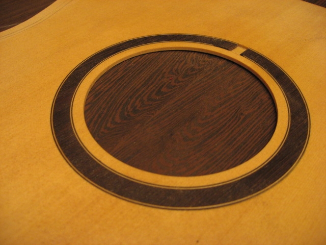

As for goings on... No.3 awaits sanding (4th round with System III) and nitro. No.2 got a neck reset, new fingerboard and bridge. (Note to anyone contemplating selling their earlier guitars - Don't...) and no.4, a Wenge Baritone has its rosette...

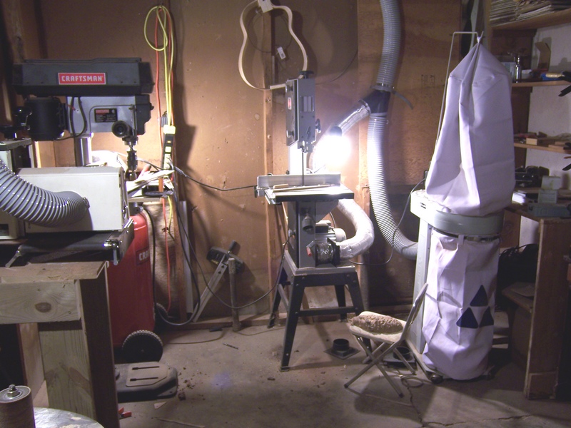

I really have been trying to keep up with you Hesh and try to work a little neater. One of the problems I have is that my band saw blows sawdust EVERYWHERE, especially when I am resawing. I have taken the door off of the lower wheel and am trying to bore a 4" hole in it so that I can better suck out the sawdust. I have also re-arranged some of the power tools so that it flows better for working and is easier to clean up too.
One of my goals for the near future is to make myself a sanding table with holes in the surface and suction below it to help keep the fine sawdust from flying all over when I begin sanding out the wood. I have the table and I have the top, I just havent moved it inside the shop yet and drilled all of the holes for the top yet.

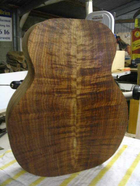

Here's one I'm working on at the moment.
Don't get too agressive with a wide belt sander with Blackwood. The heat MAY cause it it curl when you get it down under 2.5mm. I've had some blackwood do this on me - others were OK. Stickering will bring them back straight.
I have had some discoloration after getting sides out of the bender - a greenish cast on some parts of the wood. It sands out easily enough.

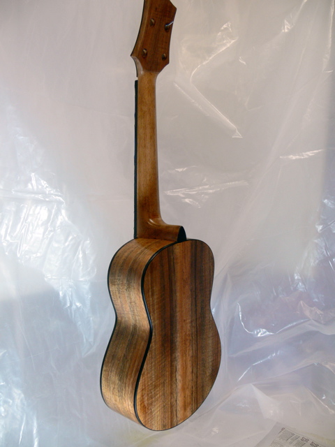

My shops too messy to show right now, but this is what I am working on.  My koa uke with 4 coats of Colortone lacquer on it.

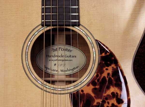

Well, the shop's a mess, as usual, so nothing new there!

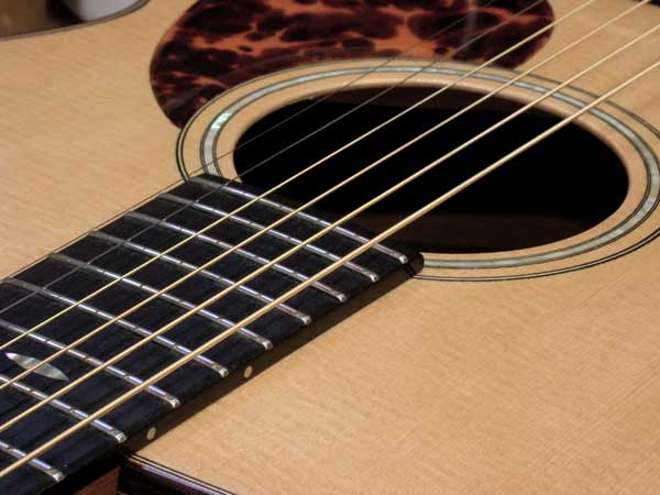

Just putting the finishing touches on the nephew's koa 000. Final polish on the frets...
...and playing with this idea for a label.....

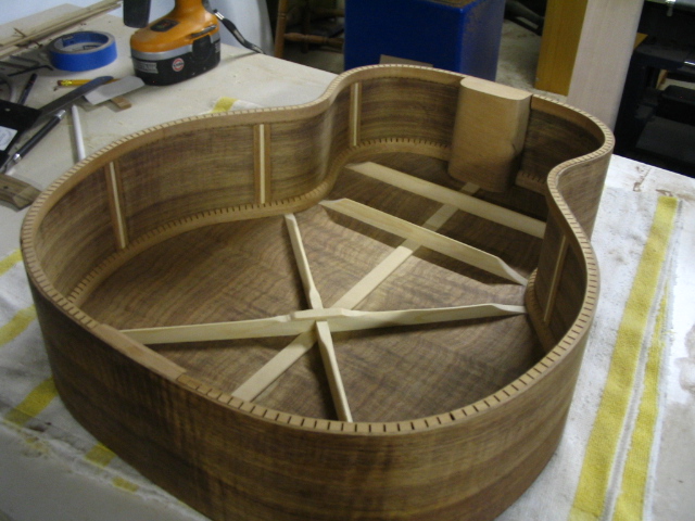

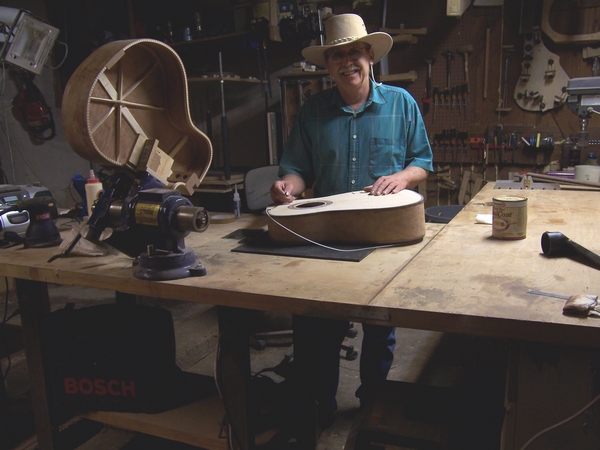

I've been slowly putting this harpguitar together.Far cry from the little "traveller" I fininshed in June.

Greg, I have always wanted to build a harp guitar. Keep at it.... looks like you have a really good go at it so far.
