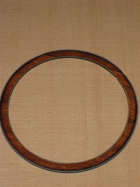

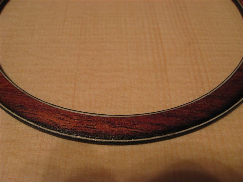

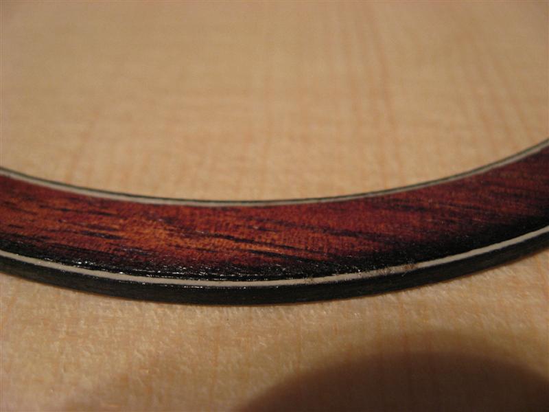

Thought I'd share a new rosette I'm trying out for a guitar I'm building for a friend. It is a new technique I learned from Michael Bashkin of bashkinguitars.com. Can anyone guess the method for getting this sunburst look on this rosette? It is Koa with a light coat of shellac on it.

Very good Dean, it is hot sand! Rolling it through hot sand vertically does this. You can increase the flame on the rosette by adding more sand so it covers more of the rosette as you roll it through. Very cool technique. I'll be doing this on the Koa endwedge also to give it a matching affect. Thanks for all the nice comments!

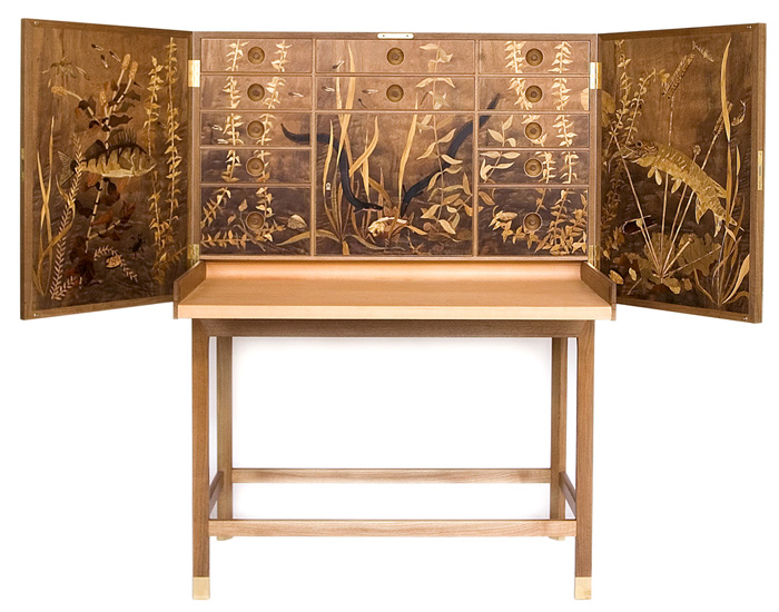

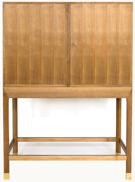

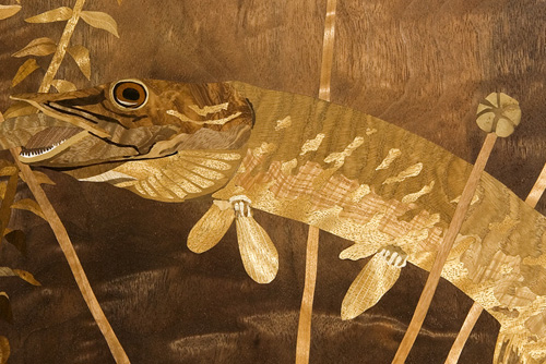

Nice looking rosette! The sand technique is very common in marquetry, a guy at the education I was in did this cabinet using the technique A LOT! Just thought id show these pics...
What can you say, 1050(!) hours!! His website: http://kjetilharket.no/en/

Awesome! pike and perch marquetry!
