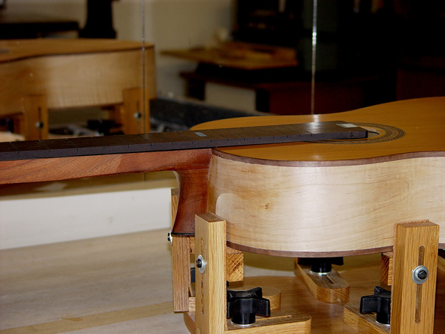

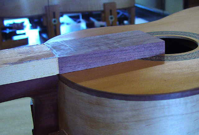

I have thicknessed, slotted, and tapered the fretboard for my first guitar. The underside of the fretboard from the 12th fret to the soundhole needs to be relieved to match the contour of the slightly arched top.
My books call for hand planing the ebony fretboard, but I'm not very confident about my skill, so can I achieve the same result by dragging a sheet of sandpaper between the guitar top and the fretboard?
I have used this technique in many other woodworking joint fitting operations.

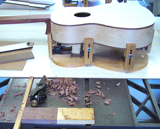

I think you'd be farther ahead to spend an afternoon (or even a whole day) to get your plane sharp and do some practice on scrap wood. Develop a bit of skill and you will be able to do this job (tapering FB underside) in a few minutes using a plane. It is not that difficult to do.
Also, once you have your plane sharp, you will be able to level the FB, tapering the bass side if necessary(after gluing and before fretting). It's a lot more accurate than trying to do everything with sandpaper, rasps, etc etc.
You'll never regret developing more woodworking skills. Anyway, isn't that the point? If you just want a guitar, it's a *lot* cheaper to just buy one.
BTW- I concur with the advice against dragging sandpaper between the top and FB, for another reason as well. It's difficult to avoid loose bits of grit getting under the smooth side of the paper and scratching the 'good' surface. I've had to learn to be very careful about this when fitting necks to sides by 'flossing'.
Also, contrary to some advice you may get, it's not necessary to have a very expensive plane to do this sort of job. Take what you've got and get it sharp and properly adjusted.

Thanks to all. I took John's advice and sharpened my block plane and started practicing on a Walnut/Poplar leftover piece from an IncraJig project.
In no time at all, I am getting pretty good results.
I will make a few more trials on scrap hardwood, then re-sharpen and give the ebony a try.
