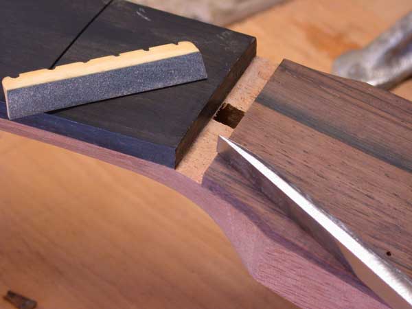

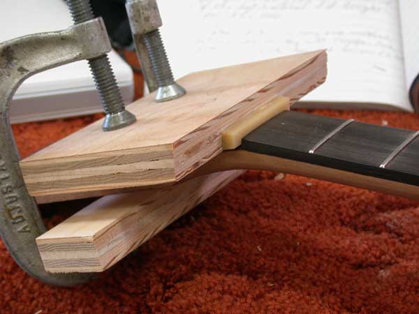

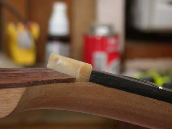

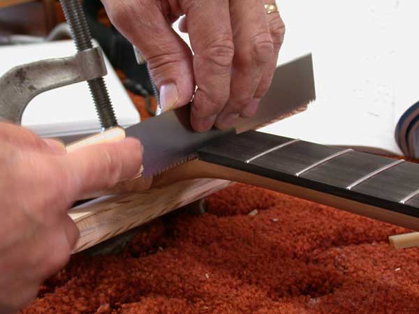

Here's what I do.
I start with a rough nut, sized on its fitting surfaces, bevelled on the bottom, not shaped on top nor cut to length. The bottom of the nut is bevelled on the disk part of the disk/belt sander, with the table at the desired bevel. A plywood guide is bevelled on the edge using the same table setup as for the nut. The nut and guide now have identical bevels to match the headstock angle. The nut is placed against the end of the fretboard as a spacer, then the guide is clamped very snug up against the nut, like this.
Remove the nut. I now have the guide's bevelled face coplanar with the tuner side of the nut. Using a small Japanese saw, or X-Acto saw, cut the end of the headstock overlay while pushing the saw up flat against the guide. Stop just shy of the neck wood.
Break out the cutoff of the headstock and clean out the slot with a narrow chisel. Sometimes
I use an old nut with a piece of sandpaper glued to it.
We now have a slot sized to the rough nut.
Shape and finish the top portion of the nut. This one still needs some material taken off the height.

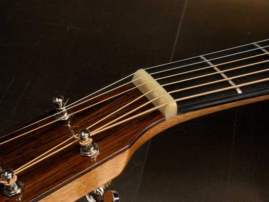

PostPosted: Thu Sep 27, 2007 12:43 am
Bruce...Here's the sequence I use.
Glue the FB to the neck.
I usually seat my nut on the angled headstock. That requires that I have the north and south sides of the nut parallel to each other.
The bottom is angled at 15* by sanding on the disk sander with the fence angled to 15*. It then seats perfectly to the angled surface on the headstock. Keep tweaking until the south side of the nut butts up perfectly to the FB.
The headplate edge is angled at 15* such that it fits perfectly to the north side of the seated nut. I use a tablesaw to make the cut. Once all those angles are established, I glue the headstock such that all 3 sides are perfectly seated.
On the bottom side of the nut I only put 2 very small dots of the weakest glue I have. No need to adhere the nut to the neck so tenaciously. It should release with a smart tap from a wooden block. In some cases, I have forgotten the glue and it seats well enough without any problems.

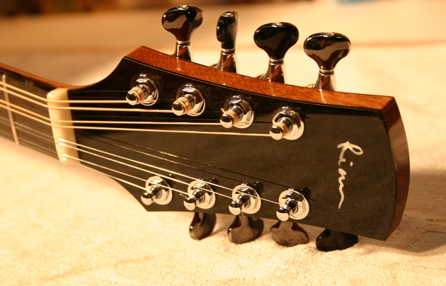

Rian, that's a beautiful bouzouki nut and finish job. I just enjoyed it again this evening. My nephew was over and I showed him Andreas Aase playing it on You Tube.
