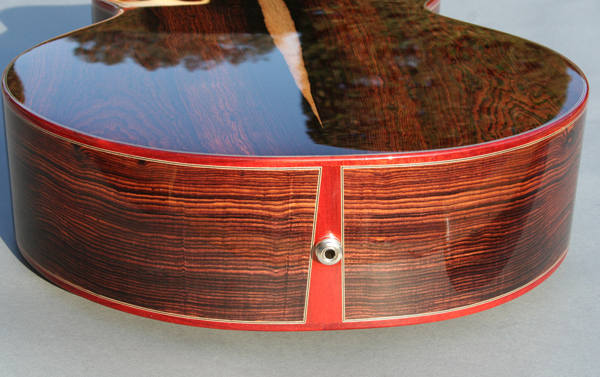

PostPosted: Wed Sep 19, 2007 5:40 am
If bold BWB are used I agree they look out of place. but I have to say in my opinion BWB or other thinline .04" or .06" side purfpling if miter jointed adds a refined finished look.
this is one of those things that is a personal view.

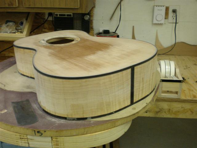

PostPosted: Wed Sep 19, 2007 5:54 am
Mike,
I could have it either way.... both look great and so far I have it done with or without with great (visual) results.
Depending on the wood combinations I may prefer to use purfs.

PostPosted: Wed Sep 19, 2007 6:27 am
Posts: 2485
Location: Argyle New York
Last Name: Collins
City: Argyle
State: New York
Zip/Postal Code: 12809
Pete;
Nice work!
But the second guitar needed NO side purfs at all to my eye!!
Unless it was Coco & Maple!
But it is subjective as Mike said!
That's why I started this post !
To get as much input on the subject as I can!!!!
Thanks -man those are beautiful guitars!!!

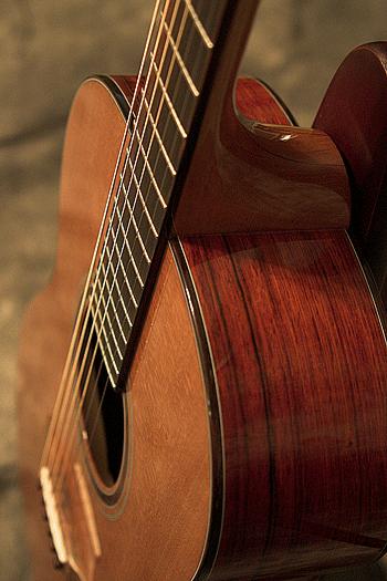

PostPosted: Wed Sep 19, 2007 6:30 am
Posts: 2485
Last Name: Collins
City: Argyle
State: New York
Lance ;
Is that an incredibly well cut top or what!!!!!!???
Looks like cedar!
Nice -I do like the one line purf.!

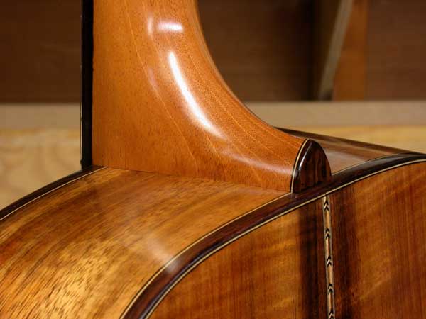

PostPosted: Wed Sep 19, 2007 2:35 pm
First off, a big round of applause to Pat Foster's side purfling/heelcap purfling detail.
Holy cow, that's not only beautiful, but perfect.
A very difficult feat to pull off--to line those up "just so"--and you did it. Great work!
Ok,side purflings: I've been wondering why I like them so well, when they require so much extra work. The reason I keep coming to was that my lutherie tastes were formed mainly during the reading of David Russell Young's groundbreaking book. He himself was guided by the classical guitar aesthetic, and that came through on all but his simplest models. It was a revelation to me of what a thing of beauty a guitar could be...as well as being a musical tool. Why not try for both?
Someone above has mentioned the thought of a picture frame, and that is what the purflings seem to add. With the framing, there is an accentuating of the back/side woods, not a detracting. (If not overdone.) And, I'll state my conviction that b/w/b (or w/b/w) is the perfect foil for natural colors. There is zero competition, no clash. And thus instead of drawing the eye away from the side or back, it adds that tiny bit of zest that enlivens them. Plus, it just bespeaks "care".
PostPosted: Wed Sep 19, 2007 10:45 pm
Kudos to the Pat Foster guitar as well. Total class.
