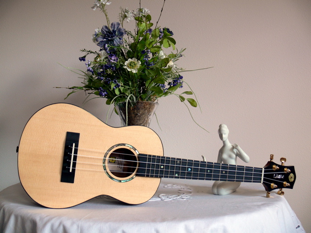

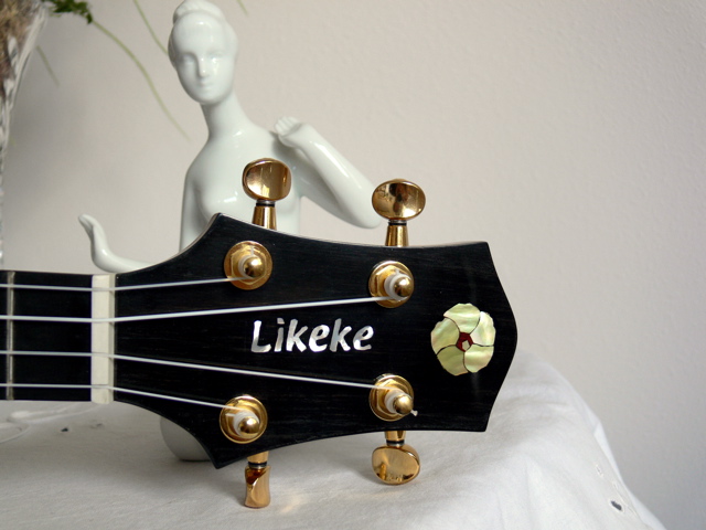

Here's my latest effort.  A tenor uke with sitka spruce top, koa sides and back.  Binding is ebony. Inlay is pua abalone except for logo which is white MOP and yellow MOP hibiscus. This one features a battery-less MISI Acoustic Trio undersaddle pickup.  For some reason string one is not amplified as much as the others. If anyone knows why I'd like to hear from them.

Just beautiful! I love everything about it! Congrats on a real beauty. How many have you built? This better not be #1 or I quit!

PostPosted: Mon Oct 01, 2007 7:43 pm
Rich,
That's gorgeous - beautifully put together.
Does the spruce top give a very different sound than an all koa uke? I'd love to hear a soundclip. Are the tuners mini Gotohs? I notice that LMI does Gotoh uke tuners that look interesting.
I still have making a uke on my "radar" and am getting very tempted by the harp-ukuleles like these.
I'm afraid I can't help much with the pick-up problems as I'm no expert and others here will be more help to you. It could be to do with proper contact over the full saddle length but I have read that sometimes if you use bone for the saddle, different densities along the saddle length can cause problems too.

Dave, the only other uke I built was an all walnut.  This one is more responsive.  Steve Grimes told me that he didn't like all koa guitars, because he thought that spruce tops produced much better sound.  The tuners are mini Gotohs.  My next one will feature open geared Gotohs which are a lot lighter, but a bit more expensive.  You can get them for a decent price at the hanalima site.  Rich

I really like your ukulele. Did you saw out your pearl yourself? Comparing the two e's they appear slightly different which makes me think they weren't Cnc'd.

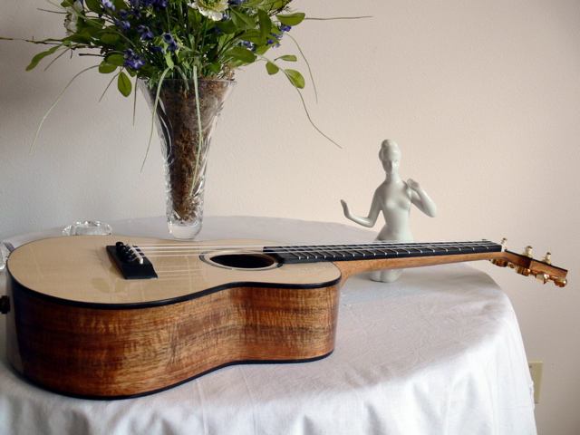

Mmmm, love the koa w/ ebony binding look.  Beautiful.  Out of curiosity, how deep is the body at the end block?  I haven't seen many tenor uke's, so that thing looks huge to me.
As far as the pickup, my only thought was that of Dave's - and that's coupling.  Certainly could be something else, that's just the first thing that popped into my head.

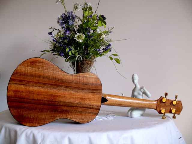

Very fine Uke Rich. Love that Koa !

Bruce, I did the pearl cutting and inlay.  Not my favorite part of luthiery and would gladly farm it out.
Csmonty, the design is based on a Hanalima plan and is 3" deep at the the tail block.  Actually the design calls for 2 3/4" at the head block going to 3"  two inches aft of the waist and going back down to 2 3/4" at the tail.  I just didn't like the look of the tail end so I left it at 3".  I may try a Wickham plan, since I think proportions of many of the parts such as the fingerboard and bridge could be reduced. Thanks for your comments. Rich

That is a very nice looking ukulele. You have done an excellent job. I really like your headstock and the choice of tuners to match the koa and the gold inlay. The bridge looks a bit hefty but I’m sure it will work fine. But I agree on the pinless pass through bridge for string attachment. I ‘m planning on the same pinless style on all my ukuleles.
