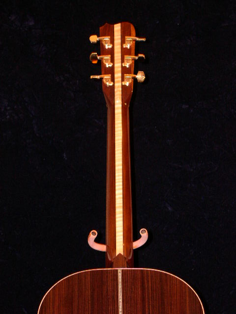

PostPosted: Wed Oct 03, 2007 2:37 pm
Here's a second (or third, or fourth, or whatever vote we're up to) for using red maple for neck wood.
If you have concerns about strengh/stability of your piece, you could always laminate it inbetween something:
This is some curly red maple sandwiched between two rosewood strips w/ outer lams of hond. mahogany.
Oh, and Todd, thanks for the nice comment!
