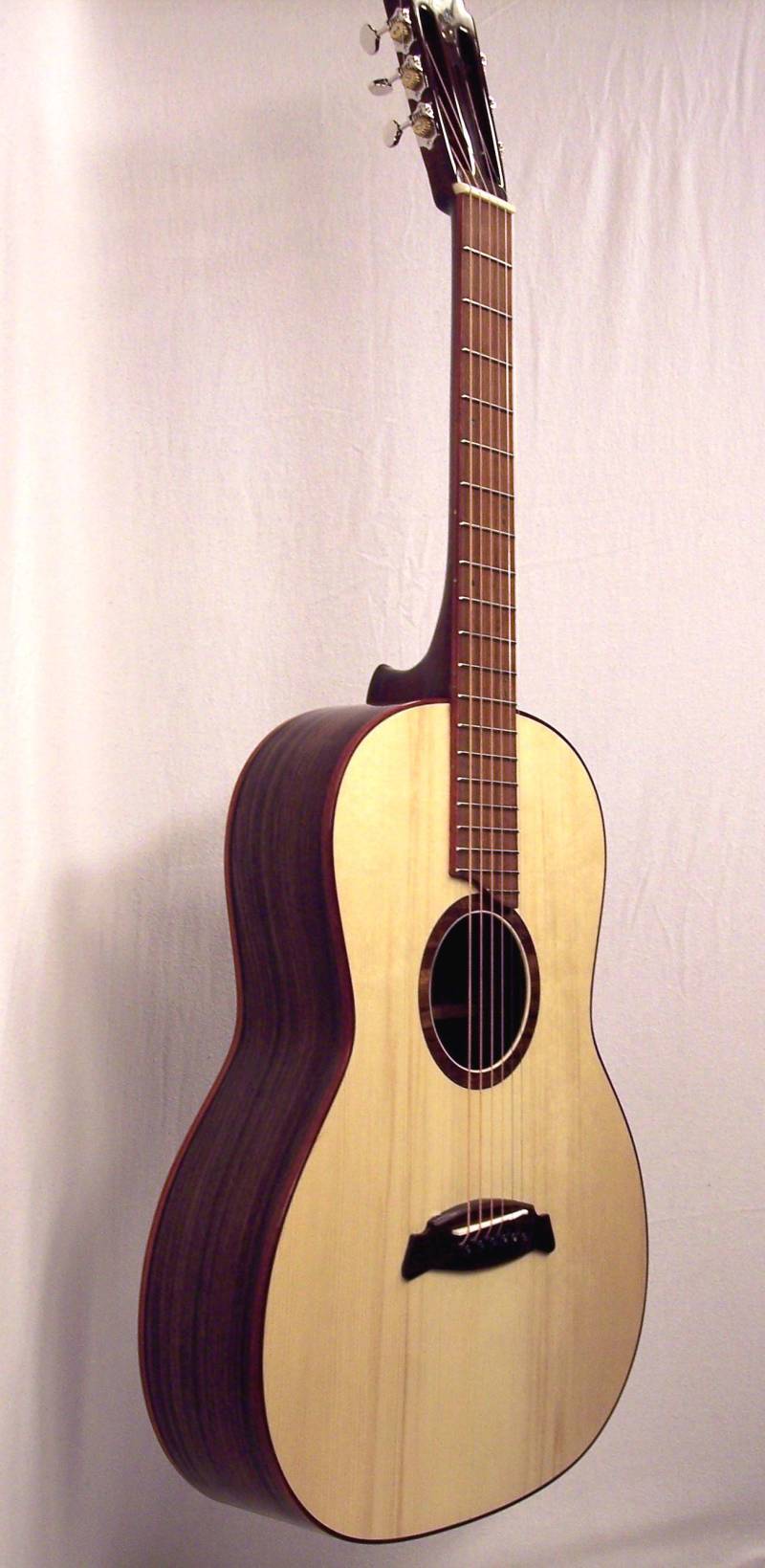

I used spanish cedar on this one.   So far, so good......

...and David, that's a real beauty!
