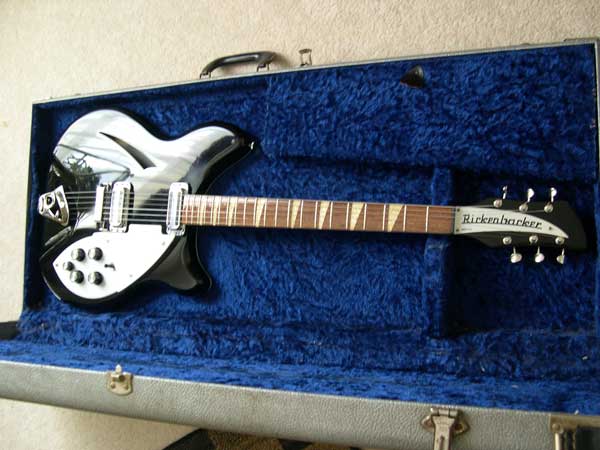

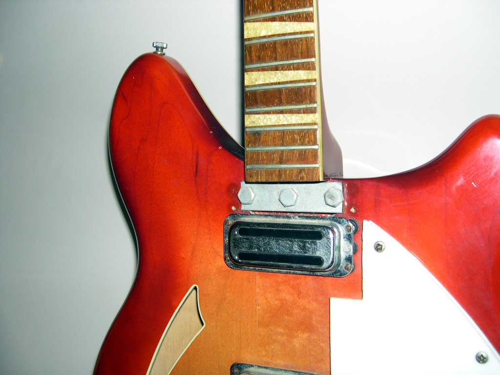

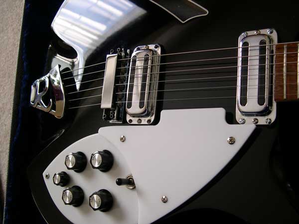

Well, after 5 months of mostly sitting around in the basement, my first restoration project is complete. I have to give props to all the guys here that helped me from painting around bindings, to lacquer schedules, to buffing arbor setup, to proper use of hide glue for repairing cracks.

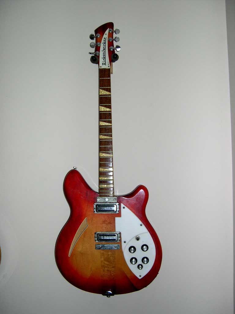

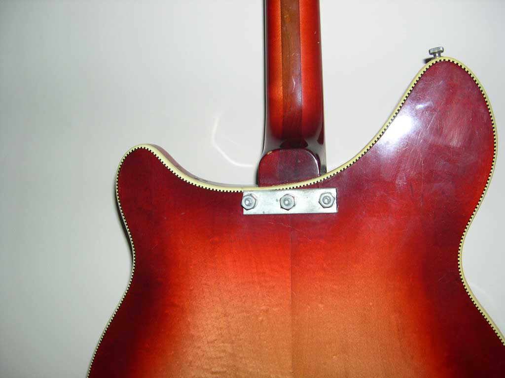

As you'll see in the pics, the main reason I had to change the color was to cover up the damage left behind by Dr. Frankenstein from a previous neck reset. This time it was done without the help of bolts, and lucky for me jetglo black was a standard color in 1966.

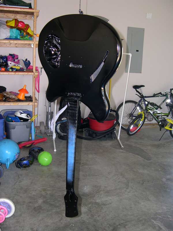

I also have to give credit to StewMac for all the supplies I received from them. This entire job was done using their rattle cans of lacquer along with their buffing arbor and compounds. I can't say enough good things about how easy it was to use their compounds to get a great looking finish. BTW this was my first lacquer job ever. I also must say that the garage worked great for a spray booth. I always thought I needed a big fancy spray booth to get good results, but I wouldn't hesitate at all to spray more guitars out there.

How did you extend the fret board?  Did you have to replace it?

It looks more like the pickup was moved up towards the neck (notice it's position in relation to the pickguard before and after).

[QUOTE=WaldenWorx] How did you extend the fret board?  Did you have to replace it?

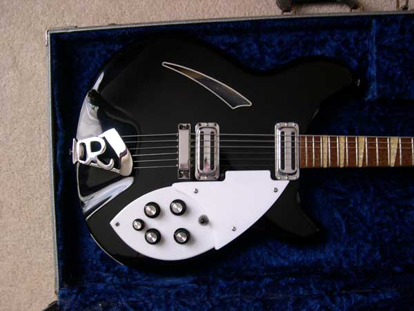

Actually, I was lucky and didn't need to extend the fretboard. The original "artist" moved the neck pickup back about 1 inch to make room for his modification. Once I removed the bolts, I reset and glued the neck, moved the pickup forward to its original location against the end of the neck, and then had to patch all the damage left behind from the extra routing and holes he put in the guitar. It's really hard to explain what a hack job the first guy did.

Err, wait... is that a whole new pickguard?
PostPosted: Thu Oct 04, 2007 8:32 am
Posts: 993
[QUOTE=csmonty] Err, wait... is that a whole new pickguard?
Good eye, actually, only the top portion of the pickguard is new since the old original was cut up to make room for the pickup after it was moved back. Luckily this is one of the parts Rickenbacker still sells. They will not sell a truss rod cover or the "R" for the bridge support (to cut down on forgeries).
PostPosted: Thu Oct 04, 2007 8:36 am
Joined: Thu Sep 20, 2007 4:22 am
Posts: 12
That second picture is what tipped me off.  The pickguard looks a little hacked up there, then nice, perfect, and pearly white in the bottom pics.

The case looks like an original Rick box.  Great finish job.

hack-work! Do you have any pics of the neck when you had
it apart?? I'm interested in the neck joint.

Aww man.... I liked the bolts. Why'd you get rid of them?

[QUOTE=Don Williams] Aww man.... I liked the bolts. Why'd you get rid of them?
Nice looking job...[/QUOTE]
I didn't get rid of them, I still have them on my workbench. I'm wondering what I should do with them? This entire project takes the bolt-on neck to an entire new level. Anybody else using a bolt-on method like the one in the pic?
