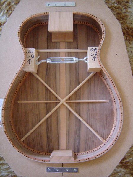

Im interested in using a cross brace on the back of my 12 string. I recall
Allan Carruth using these on some of his guitars. Could someone kindly put
up a few pics of their cross braced backs so I can have a gander at same?
Thanks in Advance

This is one that I've just glued up yesterday.
I thought that I had some picts of ones that I've carved, but not so. I found that the back really holds the dome much better braced like this. The braces are all 7 mm X 15 mm and will be thinned considerably. This is the first back that I've added the small finger braces in the lower bout. I'll shave them down a fair bit.
Hope that this helps.

Thanks Allen, that helps alot. Just needed some idea of positioning of the
cross brace.
Cheers Martin

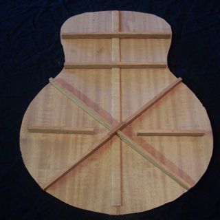

PostPosted: Sun Oct 14, 2007 8:54 pm
Here's one Martin.
There was a thread about 6-9months ago which had loads of X-braced backs. Search in the archive.

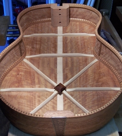

PostPosted: Sun Oct 14, 2007 9:19 pm
Posts: 201
One of mine.
