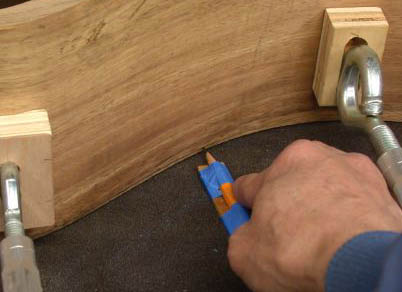

Just to add another option to the mix... Here's how I profile sides. My neck and tail blocks are cut to the right height before I glue them in. The boxes I've built so far are either cylindrical or true flat top so I don't need to shim like Hesh shows, but that looks like a good idea.
So I prop up my dish with the same size block on each end, and then my precision marking tool is set so the pencil point is the same distance as the heights of the blocks. A little tape to stabilize the dish from rocking and then you just trace around to transfer the spherical profile. Then it's quick work with a block plane to cut to the line, then glue in linings, then just a bit of sanding.

Success in profiling before bending works well as long as there's good control of positioning the sides in the bender. So, one could have success in cutting a profile on the sides, but that outcome could become compromised by poor location of the waist in the bender, a problem I once had. Profiling after bending, by marking like Jon showed in his post, would pose fewer risks in profiling. After a few more builds, with a more predictable outcome for positioning the sides, profiling before bending has a better chance of success.
I've used a method similar to Jon's, only with the rim right side up, marking the inside of the sides.
Plane or spokeshave to the line, sand lightly in dish, glue linings a bit proud. Chalk on the edge of the sides, then sand in the dish again until the chalk is gone.
