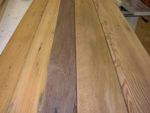

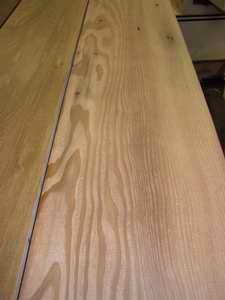

I have an opportunity to buy some really old cypress barrel wood which was used around the late 1800's to early 1900's. This stuff is extremely tight grained, rift sawn, and still has somewhat of a smell of pickles. I know there is one luthier who is building some really good guitars out of old whiskey barrel wood, but I have never heard of pickle barrel wood being used.
Is it any good for instruments? It is rediculously expensive and the widest piece is only 6" wide, so a 3 or 4 piece back would be necessary.
Anybody else interested in any of this stuff? Here are some pics. by the way, the wood has been planed and cleaned up in these pics.

But with that said, I wouldn't build a guitar with the boards pictured...
Just because wood is old doesn't mean it's good (especially if it smells like pickles and is expensive). At best you could split a piece and if there isn't much runout saw it to be quartered and have some back braces or possibly a neck.

right now I am looking at $4.50/bf plus shipping to get it here.  The problem is that I have to buy it in lots of 100 board feet. I am trying to see if any of it is reasonably verticle grained and havent heard back from him yet.

I finally got through to my source tonight on this wood. He has placed about 200 brdft of it in a kiln and it has just come out. He says that it has no smell after it has been planed and has offered to send me a board of it, relatively verticle grained and wide, for shipping cost only to try out.
As soon as I get it and can resaw it, I'll send out a couple of sets for trails if it looks promising.
