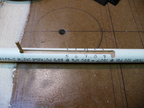

I'm still making the spring ones.  I actually spent tonight making 1/2" dowells be 15/32" so they fit smoothly into CPVC pipe.  Seems to work just fine.
PostPosted: Fri Oct 19, 2007 5:28 pm
Posts: 149
What kind/size of springs? Do you get them at Ace hardware?
PostPosted: Sat Oct 20, 2007 12:38 pm
I got them at a local Hdw company here in Charlotte, called Little Hardware.  What I liked was that they were about 5" long, small enough in diameter to fit in a CPVC 1/2" pipe, have a fairly even compression rate, that gives me a range of from 5 - 9 lbs in the last 1 1/2" of compression, with 7 being right in the middle of that,.  I posted a picture before, of my prototype, here it is again.  You can see the springs just above the prototype Go-bar.
I went out to the shop and checked to see of the package was labeled. The springs are "AJAX Springs" - Part # 54, maybe you can find them on the internet.  It took me a long time to find what I was looking for, and I couldn't order them because I couldn't figure out what would work and not work with the specs I could find on line.  I paid like $1.50 each for the first 8 or so, then I ordered 15 from them, and they gave me 3 packs of 6 and they ended up costing me about $0.75 each.  If you want to try one, I'll send you one and you can play with it to see if it will work for you.  PM me if you want me to do that.
PostPosted: Sat Oct 20, 2007 12:54 pm
Another thing, the Charlotte Pipe CPVC doesn't work as well as Genova.  It is a little smaller ID, and doesn't stay as straight.  The difference is enough that the spring is just too tight to work.  Also, you'll have to resize the 1/2" dowel rod.  I had some cold rolled steel 1/4" thick, and drilled a 12" hole until the bit had cut almost all the way through, leaving only about a 3/16 edge around the inside.  I then drilled that out with a 15/32 bit, leaving a thin lip around the edge.  Then I filed surface where the bits cut through flat with a fine file, leaving a sharp edge on a 15/32 sized hole.  Driving the dowel through from the bottom as it was drilled, scrapes off the excess, and the 1/2" back cut below allows for clearance as the dowell comes past the sharp edge.  It takes a while to do a bunch of them, but it works.  I got some tearout, but was able to sand it out pretty well.  They don't need to be perfect, just small enought to slide freely in the pipe, and big enough to not fit inside the spring.
