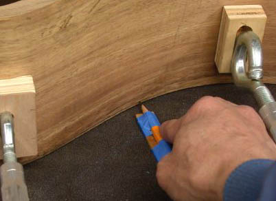

I trim in the rim. Block the dish (I use a bolt in a scrap of wood clamped in the workmate, dish goes on and can thus spin freely if need be, but only requires one clamp to 'fix' in place, then suspend the guitar body over the dish, mark the final taper (with some sort of following device keeping the pencil equidistant from the plate surface. Scrap of wood with hole in it works well), trim the taper by hand using saws (I like a small japanese handsaw) and then a plane, and THEN sand. Whole process takes maybe 15 minutes. Then linings, proud, and sand until it conforms all the way around.

Just to add another option to the mix... Here's how I profile sides. My neck and tail blocks are cut to the right height before I glue them in. The boxes I've built so far are either cylindrical or true flat top so I don't need to shim like Hesh shows, but that looks like a good idea.
So I prop up my dish with the same size block on each end, and then my precision marking tool is set so the pencil point is the same distance as the heights of the blocks. A little tape to stabilize the dish from rocking and then you just trace around to transfer the spherical profile. Then it's quick work with a block plane to cut to the line, then glue in linings, then just a bit of sanding.
