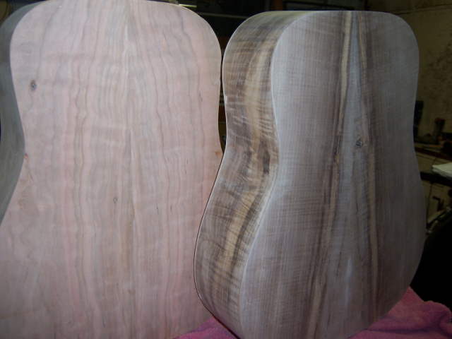

I'm building a dread with flamed oregon myrtle. After sanding it to about 220, I notice that I dont see many, if any pores. Does this wood require pore filling?
Also, any suggestions on what binding to use on it? I has a somewhat green hue to the wood, but I dont know if this hue will last for long. I'm leaning toward rosewood bindings, but ebony looks good on it as well. would a lighter colored binding like maple look better?

I know somebody is going to ask, so here is the picture. Beside the myrtle is a cherry dread as well.

       Myrtle doesn't have a lot of open pores, but I still ended up filling it ( twice with Z-poxy ) before finishing with shellac , to get a glass like finish. I can't comment on a Nitro finish. It does appear to have a very light greenish hue on the lighter coloured areas.
I used fairly plain Rosewood bindings , so as to not compete with the sometimes outrageous Myrtle grain. I found Maple bindings to be a definite 'No Go " clash!

Myrtle is like a cross between Koa & Maple so it has pores but they're typically small. I think I did fill my myrtle guitar, probably with Z-poxy.

Yep, epoxy fill 'em.   Less finish coats that way.

Ken - I'm finishing a myrtle drop top in nitro on a Tele right now. I concluded that there weren't many pores too, and went at it without filling. There is some sinking into the pores, though, and it took a number of coats to get to a first level sanded finish with no sinking. I'd put the epoxy on.

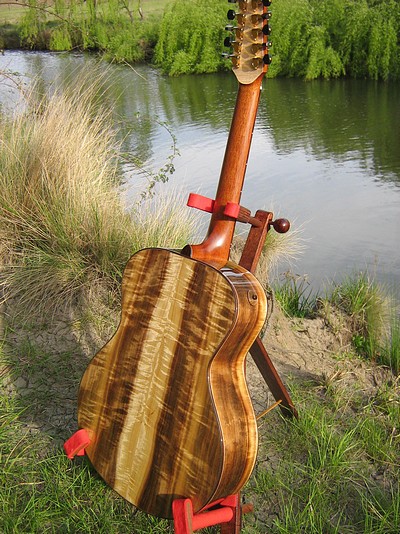

That guitar is ridiculously beautiful. Great Job!-----Snick
PostPosted: Wed Oct 24, 2007 1:42 pm
Kiwi, I cant believe how pretty that thing is. well done!
Thanks for the feedback. I guess it will be rosewood bonding and z-poxy.
