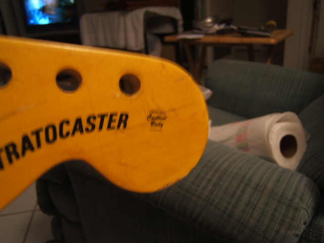

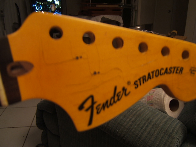

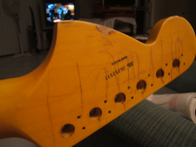

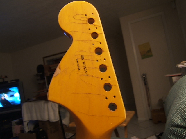

Some pics...

But if you would have asked, i'd have told you to stop when the cracks were barely visible, and not use the knife. Once the finish has split, repeated warming/cold cycles accentuate the crazing naturally. While your work came out very nice, it may have appeared more natural if no knife had been used.
that said, we all forgot to mention that one trick that antiquers use is to use a sharp knife to extremely lightly score the finish, -before- doing the deep freeze/heat cycles. That way, they force the cracks/crazing to eares that would have them first.
Also, the dirt is overkill. Natural body oils(rub your forehead, the side of your nose, whatever, with a finger and rub -that- into the cracks0 lends to a more natural, subtle look that will age correctly in the years to come. Not sure how the dirt will age...
That said, your work turned out very well(the above is fodder for the next time). well done!

Mario, many thanks as well. I know...after all that...I looked at it and said the front is better because I didn't do the "trace" part. The back looks like overkill...intentional...I know...But like you said I'll know better for next time. I am sure the customer will be happy with the results as the guitar he wants to duplicate is really beat badly and the more natural, subtle look wouldn't havve satisfied as much.
I was going to ask you...it must be getting cold up there already. Next time I ship the neck to you and you can just stick out side for a day and it will be perfect.
Another wierd note...if you noticed the "chip" on the h.s....I did that by hitting the h.s. with a real hot heat gun...it bubbled the finish...the finish dried, cooled, and then was very brittle...a little finger nail action pealed/cracked it right off. So much for the "tough" Fender finish...
