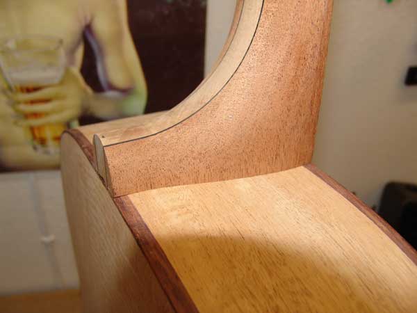

Prior to starting to align the neck and fit the neck the area around the tenon needs to be relieved so that the neck will eventually sit flush on the curved upper bout of the guitar.  Even if your upper bout is flat you will benefit from relieving the excess material around the tenon as you fit the neck.
This is what my neck looked like after I initially relieved the excess material around the tenon.
How you remove this material is completely up to you.  I use a Dremel tool with a bit that I have no idea what it is... and chisels.  Be very careful to not damage the neck on the out side surfaces.....
Please note that when using a Dremel only work in directions where if the tool slips it will not ding the outside of the neck.

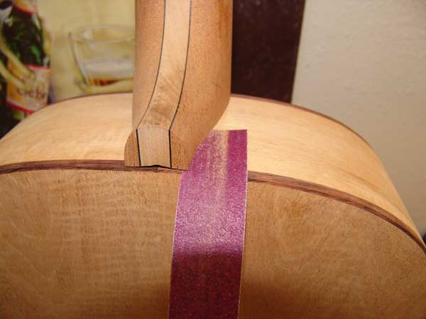

Early on in the fitting process and when major material needs to be removed I use self stick 120 grit sand paper and attach it to the guitar.  The neck is sanded on the sand paper by moving it forward and aft with emphasis/pressure applied to the high side.
Once the neck is sitting more level and I wish to only sand one side of the neck at a time I will use 1" wide strips of 120 grit and pull them between the guitar and neck.  The grit side is of course up toward the neck since that is what we are attempting to sand here.....  This process is called "flossing the cheeks...."  Really - I didn't make that up......
When flossing your cheeks... what you want to do is pull the sand paper toward you and downward attempting to use an even, full stroke.  It helps to lodge the sand paper strip right up against the tenon and I find that it tends to tear or break less when supported by the side of the tenon.
One hand is of course holding the neck in place since it is not bolted and just sitting on the guitar and the other hand is what you use to pull the sand paper strip with.  Again be sure to pull out and down.  It is very easy to pull out and up and this will create problems for the fit if you do so.
We are attempting to sand down the cheeks on the left side of the neck so that the neck will be more in alignment with the center line of the guitar.
Notice from the sand paper strip the material that we are removing.

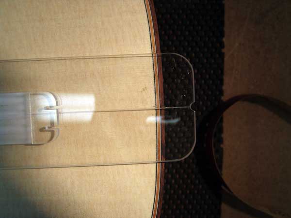

OK step two is very critical and it is setting the proper neck angle.  Although various builders use different specs for this I like to set the neck angle so that with the fret board on the neck and the bridge properly located a straight edge will skim the top of the bridge and be about 1/32" above the bridge.  The straight edge is pressed firmly on the fretboard and any bow of the fret board is pressed flat as well.
Here we see the BRW fret board and bridge located where they will live.
Although it is difficult to see from this picture the straight edge is sitting to high above the bridge.  This means that the neck is leaning to far back and the neck angle must be improved.

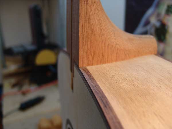

Here if you look closely you will see the the front most edge of the neck has a slight gap between the guitar's binding.  Now that you have "read" the joint you can elect to place the neck so that it over hangs the body over the binding so that when you floss you are no longer creating a gap here.
Once my neck joint is gapless I again recheck the left/right alignment and the neck angle and if they are perfect I move on to flossing on both sides with 220 grit.
Once I am satisfied that my joint is perfect I again recheck the alignment and neck angle.
Here we see that the alignment is perfect.  Remember that you can manipulate the left or right alignment simply by flossing more on the high side.
And the neck angle is rechecked once again as well.  The straight edge now comes in over the properly located bridge 1/32" above the bridge.
And the results, a very nice neck joint - here is the left side.
And the right side.
