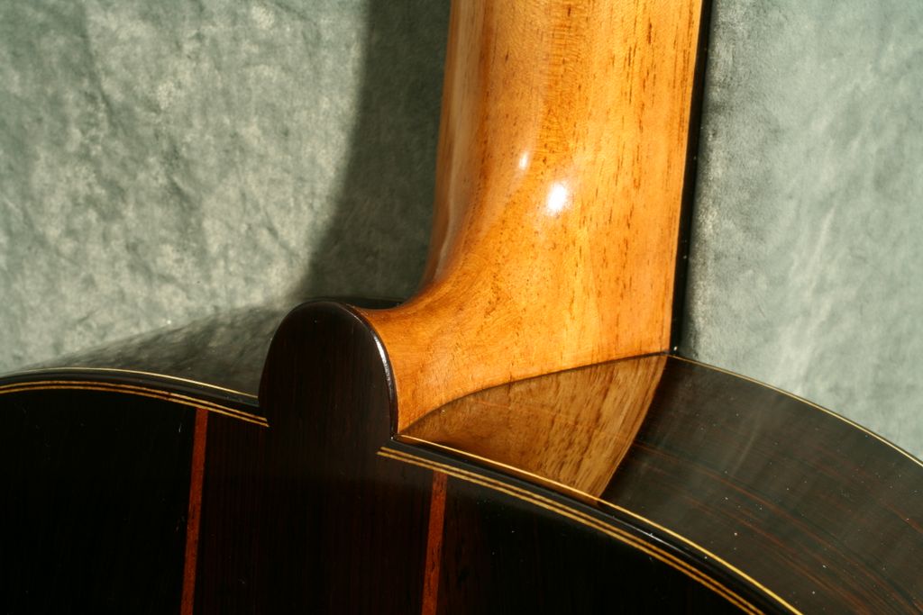

Two areas where I spend more than half of my time on a French Polish (span. heel classicals, pumice-fill), are on the sides next to the heel and on the top next to the fingerboard. The difficulty, as I’m sure most FPer’s have encountered at some point, is getting a uniform continuous level gloss-smooth-surface running into the fingerboard or heel.   For these special areas I use a very small flat muneca making figure eights staying as random as possible. A couple of problems with this technique are small radius turns and difficulty maintaining a small muneca at the proper level of shellac-alcohol for very long. I usually get close to a satisfactory result and then I hear 'tick' -- a catch or a grab of the muneca on the surface. This aggravating event creates a muneca-imprint, or cloudy area. Immediate fixing is difficult and usually results in creating undesirable swirls. So I let it dry for a day, level and start over, eventually getting acceptable results but with my patience severely tested.
I'm looking for a better technique with more dependable results if there is one. If you FP classicals (or SS with the neck attached), I’m interested in hearing what method you use next to the heel and fingerboard.

I use a pad about the size of pecan (unshelled of course <G>) and apply straight pulls next to the heel edge on the side, along the heel's edge and up and over to the other side of the heel and  again on the side next to the opposite heel edge. I then do straight pulls back on either side to overlap the side pulls done previously that left off beyond the waist on the treble bouts. I also sand (360) between sessions and polish at the end.

Looks good DP, that's the results I like but it takes me several days (maybe even a week) to get there.   I've tried the straight pulls but I always get fine streaks running parallel to the heel. Looks like you have overcome this problem.
I'm interested in your technique--need some more info, hope you don't mind a few questions. Were you able to complete this in a single day? You sand between sessions with 360, how long do you wait before sanding? What do you polish with?

"Were you able to complete this in a single day?"
No, certainly not. My polish is a four to six week process with many bodying and leveling cycles in order to build/fill the surface.
"You sand between sessions with 360, how long do you wait before sanding?"
I use non-loading paper and do not attempt to completely level the surface in the earlier phase of the work, just to knock down any lap marks etc.  Once the surface is well developed I usually go to 400 paper. Often I can sand the next day but often a week will go by until the next session.
 "What do you polish with?"
I use the series of Meguiar "Heavy", "Fine" and "Glaze" compounds to finish. Sometimes I will polish the surface just as it comes off the pad, sometimes I may use a little 600 to level it a bit, depending.
