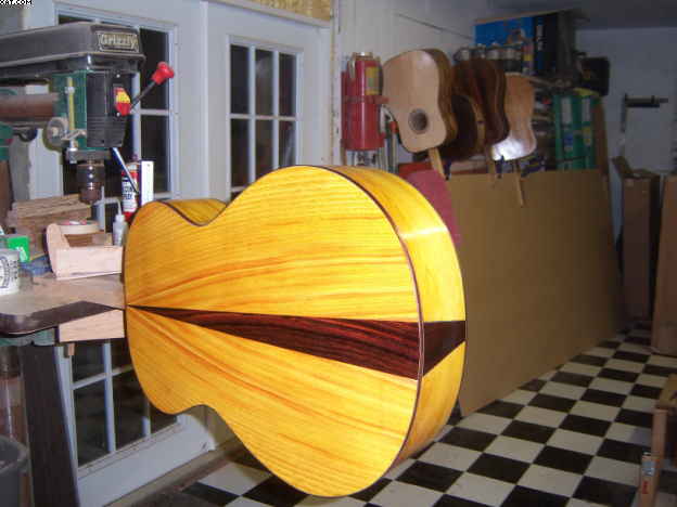

Just thought I would do a little update on the Osage Orange guitar from the swap meet. This is the wood nobody wanted, so I decided to make something out of it myself. The yellow color is kinda growing on me
If you look real close at the first picture, you can see the other 4 guitars that are a part of this set of 5 guitars I am building. Today was the first spray day, so everything has its first coat of nitro in it and is waiting for tomorrow.

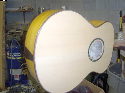

By the way, this is similar to an OM, but is 1/2" wider in the lower bout and is the same depth sides as a dreadnaught. It is my own design I am calling my OD-1 model

Looks cool, Ken! The top sure does look white against the Osage. The binding works well to frame it.

Looks great, Ken. I love that dark wedge of EIR in the back against the Osage. It's got a unique sort of art nouveau look to it. Looking forward to seeing her when she's done.

I really like the contrast!
And as Dennis has pointed out, the Top looks very white. What kind of spruce is it?
Also, I’m guessing that’s not native U.S. Osage orange, which is quite orange, and under a finish
looks almost red. Where does that Osage come from?

Ken buddy it's looking great.  It is yellow but a much warmer yellow then I would have thought with some finish on it.
Great job buddy!

Wow, I mean, just wow. Stunning and that backstrip is just breathtaking, the way you've arranged the figure..

Ken, looks great! I like the contrast between the Osage and the EIR... well done. Please let us know how it sounds when you're finished, a sound clip would be nice.

The Osage Orange came from a friend of mine that owns a sawmill in Indiana. I have more of that wood laying around and more on the way. It is extremely bright yellow! After one coat of nitro, it appears to have mellowed some, but still has an almost 3D effect in yellow/gold/brown going on. I had tried to stain it with stewmac's wood stain, but even full strength the stain wouldnt absorb and just sat on the surface. This is some extremely tight grained and dense wood. I didnt even use pore filler on this guitar and so far everything looks lovely.
The spruce is Englemann spruce that I got from the ebay seller that sells tops in lots of 50. So far I havent been dissappointed in anything he sent me.
The wedge in the back started out as a fingerboard blank. Because of the curved lines, it wasnt desirable either but has turned out beautifully as a back wedge. The tail wedge started out it's life as a headplate from a Martin pre-carved neck I bought. I removed the headplate and added one of my own. Just couldnt see throwing the old headplate away and thgouht it would come in handy some day. The rosewood binding came from Shane at highmountain tonewoods. Good looking stuff!
I am trying something different with the bracing on this guitar. I have carved it much smaller than I have been using on my other guitars just to see if it will hold up. The cross brace is 1/2" tall where it meets in the center and is 1/4" wide. The top has been baked for 2 hours at 200 degrees also.

That's a really neat looking guitar, Ken.  The color is initially a little shocking, but it grows on you.  The tapered wedges really make the look work.  Nice job.

Ken I really like the way that back wedge is mirrored in the butt wedge. VERY creative. Wish I had thought of that. Hope you don't mind if I copy it sometime.
The contrast is great and the colors match very nicely. The binding carries on the theme in the wedge, etc. Just great!
