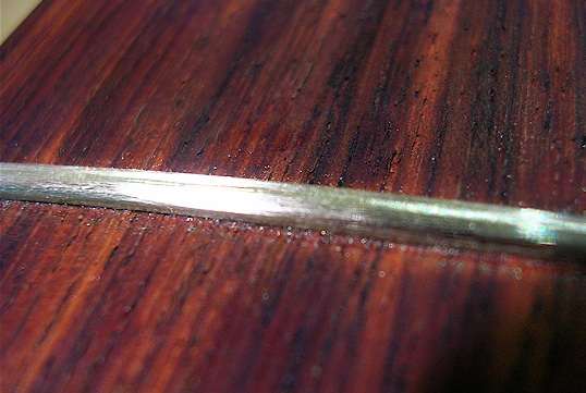

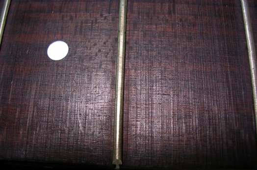

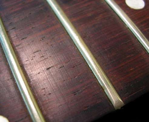

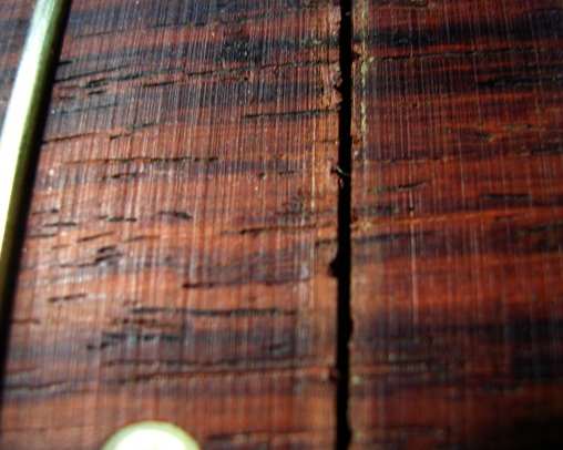

I’ve always been conscious of the tooling marks left on Gibson fret boards
from the teens through at least the 60’s, and been careful to preserve
them in fret dresses for some sentimental reason. I had always assumed
that they were from the machining of the board, though the direction of
the markings seemed counterintuitive.
It wasn’t until a recent 30’s Gibson refret that I really noticed how
markedly high the plateaus were that the frets rested on were, beneath
which the board was clear of markings. I tried thinking of several ways of
sanding, filing, etc., that the markings could have been made post
fretting, but none made sense at all to be a Gibson factory procedure.
Finally it occurred to me that they had to have buffed the frets and
unprotected board with a very course wheel in what little dressing
process they used. I went through a few different wheels trying to mimic
it, and finally settled on a fine (.008”) crimped wire wheel. Following this
with an aggressive buffing on a wheel with tripoli compound was enough
to polish the wire markings from the frets, leaving the board looking
perfect vintage Gibson.
Duh. Crude, quick, effective. “Good enough” in a nutshell for the period
Gibson factory instruments.

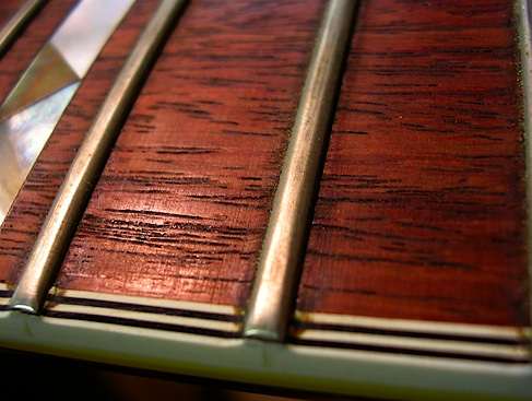

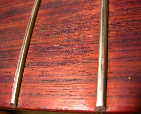

PostPosted: Sat Dec 01, 2007 6:22 pm
Posts: 2060
Here's a few examples
10's
20's
30's
PostPosted: Sat Dec 01, 2007 6:24 pm
Posts: 2060
40's
50's
60's

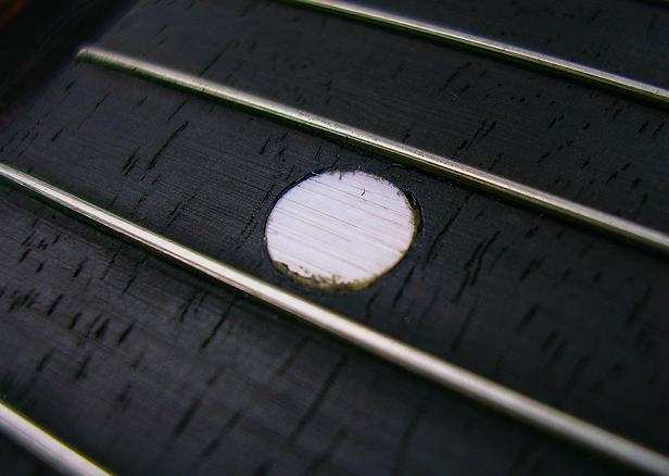

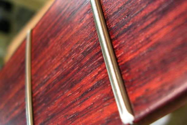

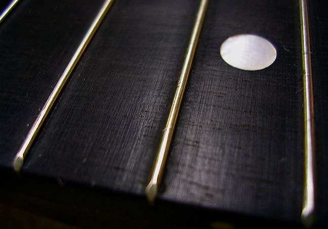

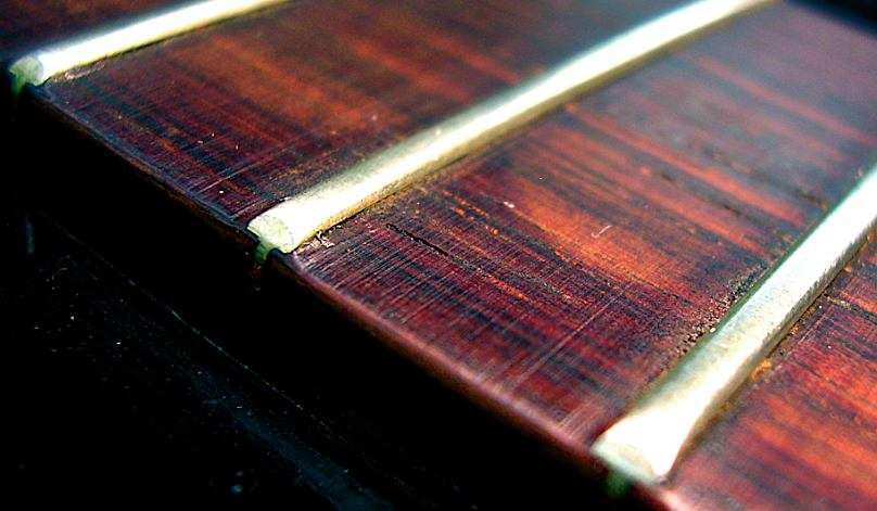

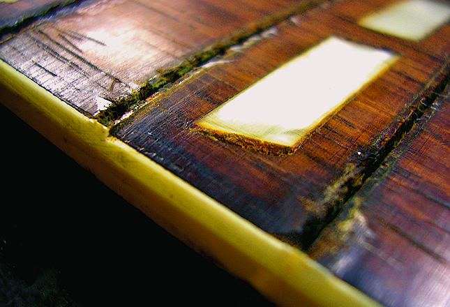

PostPosted: Sat Dec 01, 2007 6:26 pm
Posts: 2060
And it wasn't limited to Gibson. And of course even more crude would be the
Chicago instruments.
Here's a Supertone
And a Harmony, from the same factory I'm sure.

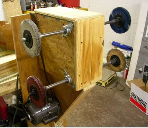

So while browsing Grainger for a decent 6”-8” wheel to put on a grinder
to mimic this on occasion, I stumble across 3M’s “radial bristle” wheels.
Thanks to being introduced to these by the goldsmiths upstairs, I’ve been
using the tiny Foredom sized ones for metal polishing for a few years, but
never realized they were made in 6” and 8” sizes. The beauty of these
tools is their flexibility, and ability to conform to the shape of a fret
without putting any disproportionate pressure directly on the top.
These were only introduced about 6 years ago, but with the little
experience I had with them I thought it worth a shot to see if they could
perform a Gibson-style fret polishing with less damage to the
fingerboard. So to save space I picked up some good shafts and bearings
and set up a stacked arbor. Not the most ergonomic, but you do what you
have to when space is limited. It’s still temporarily screwed to an old
bench in the “under construction” section of the shop, so don’t hold the
mess against me.

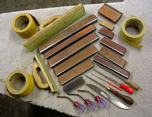

PostPosted: Sat Dec 01, 2007 6:31 pm
Posts: 2060
So here's most of my fret dressing tools.

I use the files for course leveling, but really like the float glass planes for
final truing. Since I can level the glass on my surface plate I have a lot more
control over their quality than with files, and like being able to choose grits.
In this example I’ll show the long plane was fit with 120 grit for course
leveling. Then 300 grit diamond file crowing, then the shorter plane with
220 for a second tighter truing. In the spirit of plate leveling from machinist
days, I will sometimes repeat this procedure several times at lighter grits
and pressure to reach tighter tolerances with each round. Here’s the leveled
and crowned fret. My apologies, but I don’t have the camera, lighting, or
skill to get a good macro shot of metals, so take these photos for what they
are.

In experimenting with the buffing system I tried the 120, 220, 400, and 6
micron radial bristle wheels, along with cloth wheels with jewelers rouge
and with tripoli. The 220 wheel (spinning at around 2800rpm) was not
aggressive enough to easily get out the 220 grit from the final leveling
plane. Maybe some CAMI / FEPA conflict, I don’t know. I could get it out if
I really hogged in to the wheel, bet it ended up leaving a slightly stippled
look to both the wood and the frets, which the 400 would not get out.
The 120 wheel would take out the 220 leveling scratches, but grooved
the fingerboard noticeably. So what I’ve ended up doing is quickly kissing
the tops with a bit of 320 sandpaper before approaching the 220 wheel.
I run the board along the wheels from the center to off the edge, tilting
the neck to hit the frets at a slight angle one way, and then shifting to the
other to get both sides well enough. Then I flip the neck around to roll off
the opposite side, as in bass or treble sides.
I initially had problems with each successive wheel fully removing marks
from the previous grit, as though there were too big a gap between grits.
Finally I started taking a series of lighter passes on each wheel before
moving to the next grit. 220 heavy, 220 light, 400 heavy, 400 light, 6
micron heavy, 6 micron light. 0000 Steel wool, then wax. So far this
seems to work beautifully.

This neck photographed didn’t really need a dressing, but it was one of the
few expendable necks I had left around which hadn’t already had the board
ravaged in other experiments. Here’s the before board.
And here's the after.
PostPosted: Sat Dec 01, 2007 6:43 pm
Posts: 2060
No tooling marks, no notable rolling of the edges, no rolling of the fret
ends at all. From finishing of the filing to the waxing of the board takes
under a minute. There may be a bit of a learning curve with these wheels
as well, but so far it seems like a system with potential. At $50+ per
wheel, they’re not terribly cheap, but if you do any amount of fret dresses
they can pay for themselves in saved time pretty quickly.

Well, in the first place, Gibson fingerboards and fret work has traditionally been among the worst ever in the guitar industry. If any company consistently got it wrong decade after decade, it was them. I'll take a run of the mill 1962 Harmony fingerboard over most Gibbies any day.
Then, if you want that high shine on the frets, just mask off the 'board between the frets and do your level and crown and 3M sanding sponge work, and then put it on a 10" wheel buffer with emery and then Tripoli buffing compound. Somehow, I've managed to collect more double arbor buffers here than we know what to do with, so having one just for frets isn't an issue.
The 'board should never ever show evidence of cross grain sanding, buffing, scratching, scraping or anything once the job is done.
