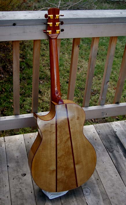

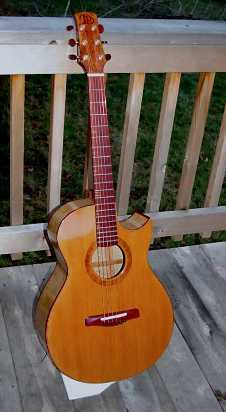

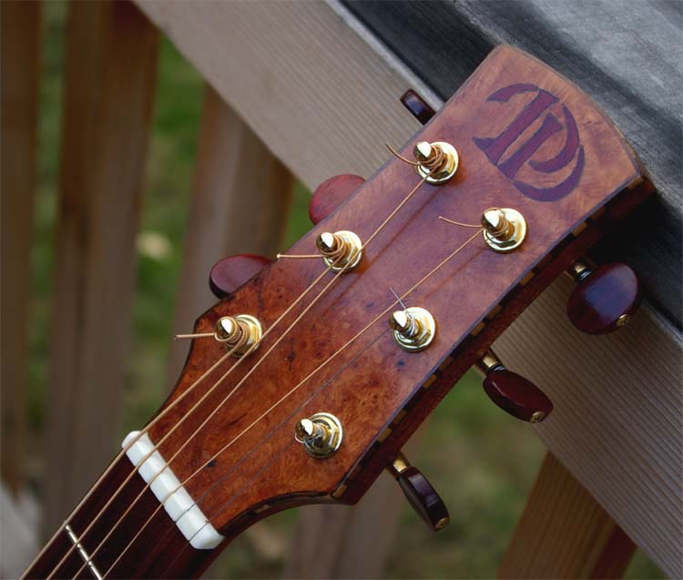

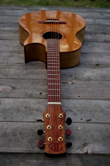

Hi everyone,
    After months of shamelessly lurking and borrowing ideas I've finished my first build.  Since everything I know about building came from all of you, it only seemed fair that I finally post the results.
    My previous guitar was built by a college room-mate who sold it to me in '80.  Ever since I've been wanting to build one myself, but it's only since returning from a work stint in Peru about 5 years ago that motivation plus opportunity finally got the best of me.  I came across a piece of perfectly quartered, tight-grained douglas fir in my brother-in-law's garage and asked myself the fatal question, "I wonder if this could make a good soundboard?"
    I was able to find answers to every question along the way in the archives.  The fact that this forum is marked by such generosity and graciousness has given me the courage to post pics.  One of my goals was to use only woods available either here in Northern California or in Peru where I lived previously, and to build from scratch as much as possible. Here are the main stats:
13-fret neck
top:   3-piece douglas fir (The bandsaw I had access to could only re-saw up to 6")
sides:   lightly flamed myrtle
back:   3-piece myrtle (see bandsaw comment above)
neck:   mahogany
bindings, bridge, fingerboard, tuner buttons:   bloodwood
headplate, rosette, tail wedge:   tan oak burl
I took the df down to about >085" and used a hybrid x and redwood lattice bracing scheme.  To my ears it came out sounding pretty good, about as loud as my brother-in-law's d-28 but with more "air" in the treble and more clarity in the bass notes.  The treble breaks up a little if you dig in but for fingerstyle it is just what I wanted.  But then again, since this is my first build, what do I know?  I'm happy, and what else could you want?  I have no plans to sell.
Here's the pics:

Thanks for all your kind comments.  Of course, tone is what really matters and unfortunately I am not set up to send any soundclips.  A lot of the design decisions revolved around my skill or equipment limitations, like the 3-piece front and back.  I had no intention when I started to include as many difficult features as I did.  I cursed myself a thousand times for doing so once I got started.
    It is embarrassing to say how much time this build took me.  I started about a year and a half ago, working mostly in the shop of a friend who lived in a nearby town.  I didn't worry as much about the time, which I had, as I did about the money for materials, which I didn't.  There is a good chance that within the year I will be back overseas in a place with limited tools and resources, so I felt that this might be the only guitar I ever build(I'm sure a lot of you are chuckling here).  Being such a cheapskate, I got all the wood except for a small  bloodwood plank (and the top which was originally destined for a stair riser) from a local hardwood store.  The tan oak is from a smallish burl I found on the beach.
    I did a 13-fret neck because I thought the denser douglas fir might need all the help it could get.  The headstock binding, which is repeated around the tail wedge, was left from an unsuccessful first try at making purfling (too wide!).  The pics don't show the numerous goofs I made.  The bridge shape was inspired by a DeJonge bridge and just made sense to me structurally and aesthetically.  The use of wood inlays for the fretboard and headstock was another result of my not wanting to fork out for shell or a jeweler's saw-- besides, I like wood in wood inlay.
    I wasn't sure about the bloodwood for bridge and fretboard at first.  In flash pictures they can come out almost too red.  In reality they are much more subdued, which I like.
    I had a blast, in spite of all the frustrations of jumping in over my head.  I've done a lot of woodworking before, much of it with hand tools, so the woodworking part wasn't as much of a learning curve as was the exacting nature of dimensions and the luthiery/sound part of the equation.  I am already partway into my next build, a redwood-topped (from a old redwood beam I found half-buried in my dad's backyard) classical with an elevated fingerboard.  As you can see, I continue to throw myself upon my sword.  It's so much fun, though.  Thank goodness I'm not trying to make a living at this...

Oh yeah, the finish is french polish on the top and ktm-9 on the rest.  Since I was working in borrowed space I was concerned about fumes and anyway there was no room for a spray booth.
    The part that gave me the most fits was the cutaway.  Thinking that this was a once-off build, I didn't take time to build a proper outside mold.  I also stupidly didn't take the cut-away into account when I originally braced the top, leading to some improvisation.  I almost changed my mind but then thought about those upper frets on a 13-fret neck, which I do sometimes play on.  There was nothing for it (for a pig-headed guy like me, anyway) but to plow ahead.
