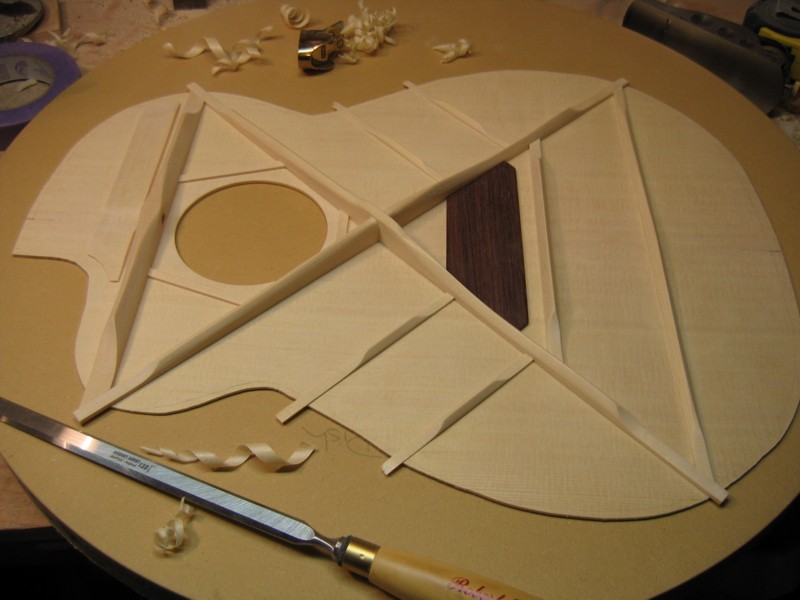

Zach,
I am using Larrivee bracing as well. Heck, Laskin, Manzer and Karol build quite well with it! I too like Larrivee's much better than Martin's. This thread shows bracing of my first top (still in progress actually ) and here is the top before I glued it on.
I changed the bridge plate to Rosewood as I think it will add "body" to the sound. I followed John Mayes advice and carved the braces until the top "came alive" and once the box was together the whole thing just about bounces whenever sound is placed into the soundhole. I have routed out the binding channels now and it is somewhat dead but I suspect once the bindings are on it will come alive again.
I digress, I don't really like the 'pads' for the finger braces and agree that the tonebar style fingers will allow for more opportunity to 'tune' the top. My pattern is a hybrid between Larrivee, the Fine Woodworking articles that Laskin did and a picture of one of Manzer's tops and I mixed in some intuition that resulted in the area of the cutaway and the upper tranverse brace shaped like a propellor to remove as much mass as I could.
Hope these help. I will pass on some of Tony's advice to me. Don't be too afraid to make these braces thin and light. Tapping as you carve the braces you will start to notice the top come alive as you approach the end of the carving exercise. On future builds I will be making the ends of the major braces thinner as well, likely in the .040 to .060 range or so.
Good luck

Posts: 332
Works for me....
A blend of Martin, Larrivee and Classical.
1/4" bracing works fine for something like this (upper transverse is 3/8")
I have done it with flat, wide, finger braces as well and didn't notice any significant difference.

Mark and Shane - beautiful tops and great pics - thanks for sharing!!!
