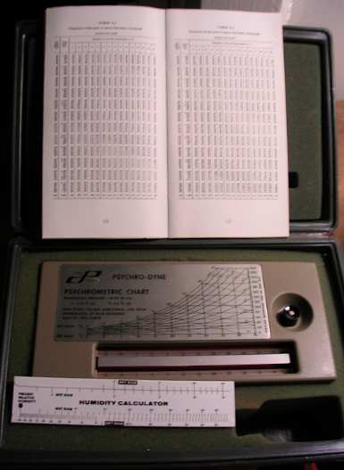

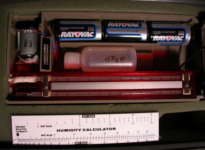

It's some logarithmic formula I've never bothered to learn. I have two
psychrometers, one at home and one at the shop, and they have a nice little
slide rule calculator with them. There are more advanced charts to
compensate for things like barometric pressure, but I don't need accuracy to
within 0.1%.   These psychrometers are essentially the same as Mario's
setup, just built in to a box.

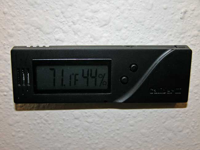

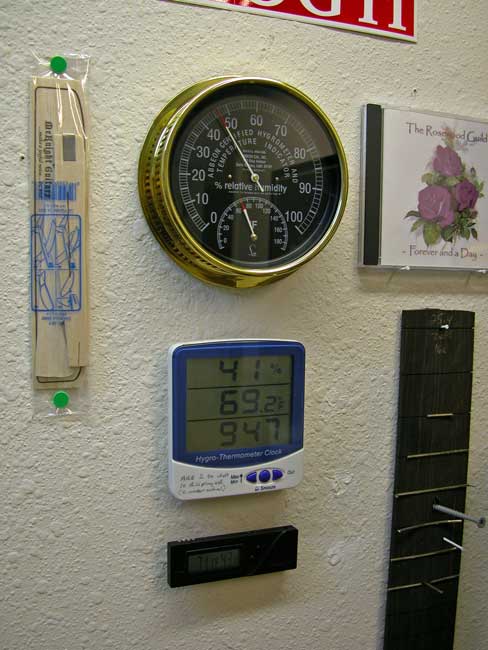

JR you can trust your hygrometer once you understand how your particular one will respond to change and you calibrate it.
There is a great thread in the archives about hygrometers where some "guest" guy takes us through a pictorial sequence of a digital hygrometer and the salt test.  In that case it took longer then a day to reach the desired 75% RH.
This is my set-up and each of the three hygrometers is accurate if you know how they individually respond.  For example, the white digital has been calibrated to be approx. 2% low in the 42 - 48% range that we seek.  The black "Caliber III" that was recommended to me by Tracy is and has been dead-nuts accurate for the entire time that I have had it.  And the Aberon reads typically 1% high.
What is important to me is that all three form a consciouses  once you factor in their individual and known biases.
In any event if there is a change in my shop I have 3 opportunities to know that something is happening.
This morning it is 12 degrees F outside so my place is dry and both humidifiers are running constantly as a result.  My shop is at the low end of the desired spectrum also as a result of the furnace being on more frequently.  And all three of my hygrometers reflect this AND agree with each other regarding the changing conditions.  That is good enough for me and I know that my shop has a stable, acceptable RH.
I am also freezing..........

Hesh, Thanks for the pics. I noticed a little balsa airplane hanging out with your hygrometers. Is that for the day your RH is so uncontrollable you'll have something to do?
