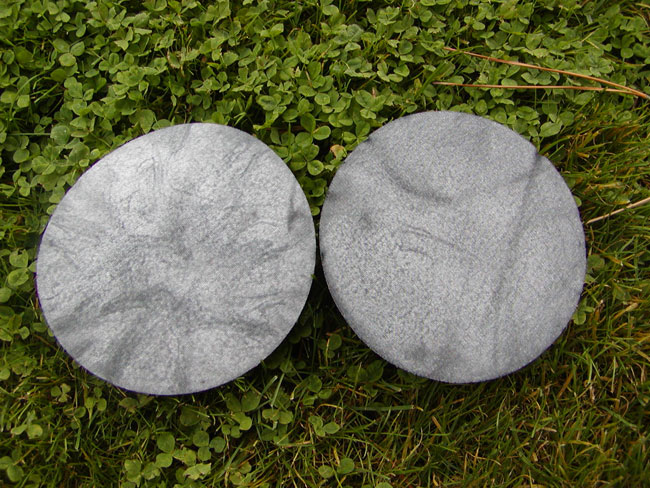

Anthony, it looks like you and I were typing at the same time.    I was using my ETS-125 and did in fact go without a lubricant.
Hopefully this picture reveals a bit more about the Platin series. The best way to describe them would be to call them abrasive pads that fix to the sander with velcro. They don't have holes for dust extraction, and in my email to Festool I asked whether or not using the vac helps. I'll paste what they write back.

One quick mention. Out of the box, the Platins are a dusty black, so any chalk color you see is the loaded finish. It's just a very thin coating on the surface.
On the left is Platin 1000 and on the right is Platin 2000.
