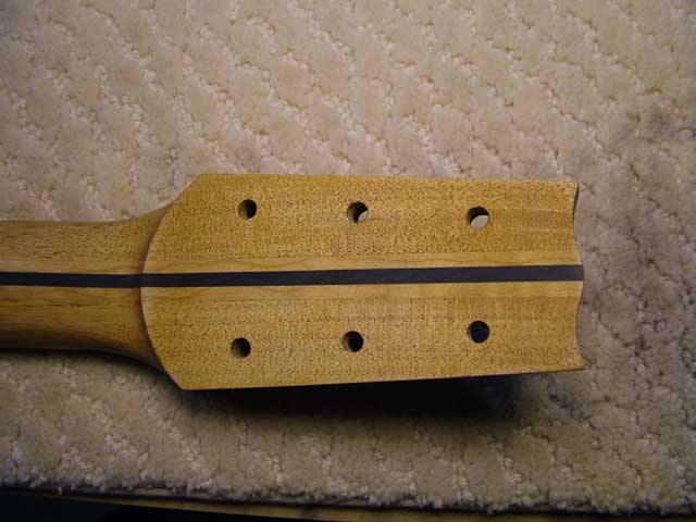

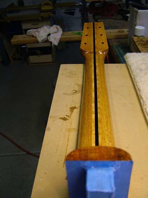

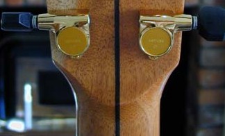

I'm building a guitar to take to Harry Fleishmans setup class, he wants the students to bring a neck unfretted so I decided it was time to try my hand at doing a volute, this neck is a very blonde mahogany with maple/ gabon ebony/maple layered in for strength (along with some CF rods burried in there as well). I spent about 3 hours friday afternoon working down the neck and with some careful carving and lots of sanding came up with this:
I'm pretty happy with the result, I've been applying epoxy this weekend getting ready to spray on KTM-9, just about there. So now I'd like to see how others do theirs, this one was purely organic, I really didn't have a plan going in and just wanted to see if I could do it..

PostPosted: Sun Mar 27, 2005 6:45 am
paul
that is pale mahogany; have to look hard to see the maple!
but the volute looks great. nice free hand work without a template. you should be very pleased.

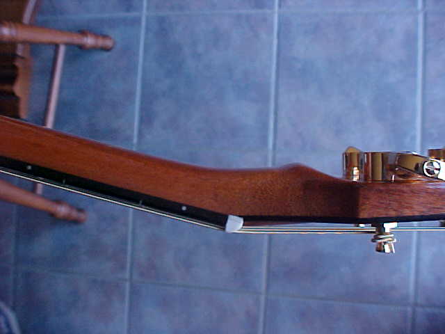

That is a great job! I carved my first volute on the very first neck I ever carved. It is not that good, but it was freehand and all just made up. I wish I was as good as you at this. But I'm sure I'll get better as I do each one. Here is a pic

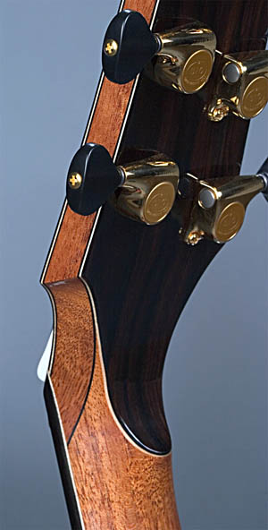

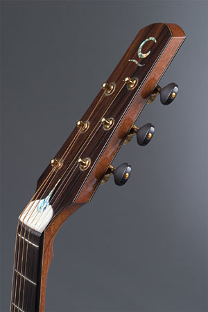

Here's one I'm using currently.
Jimmy Caldwell
PostPosted: Mon Mar 28, 2005 3:46 am
Niiice...I particularly like the fact you've accentuated the scarf rather than try to hid it in any way. Very, very elegant. How does the volute 'feel' on that when you're barring in first position, though?
What's the headstock angle on that? It looks steeper than the 15 I tend to use, but that might just be a trick of the light.

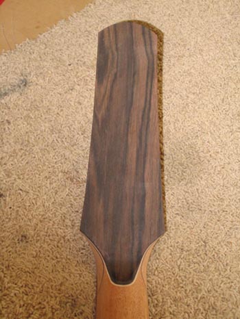

Jimmy,
Very nice! I've always wondered how you guys laminate the back of the peghead, and are still able to carve a volute. Do you have a picture of the back of peghead before you start carving the volute? I would love to see it. This would help me understand the concept. I just think it is very classy when you laminate the back of the peghead.

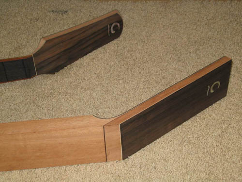

Posts: 460
Tracy,
I don't have a "before and after" shot of the actual volute, but maybe these will help.
Mattia,
The volute doesn't interfere with hand position at the first fret. This neck design incorporates a zero-fret, so it looks a little more intrusive than it is. For players who prefer a shallower profile, there are several ways to accomplish this and maintain the volute.
Jimmy Caldwell

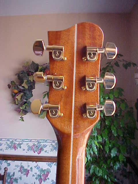

Posts: 267

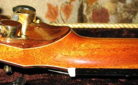

Here is one from my file photos:
PostPosted: Mon Mar 28, 2005 8:18 am

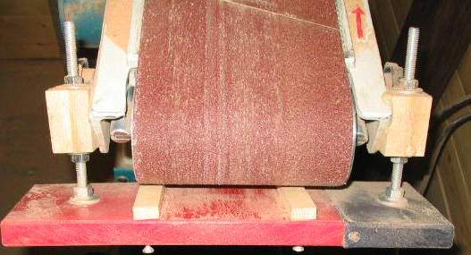

Posts: 1595
State: ON

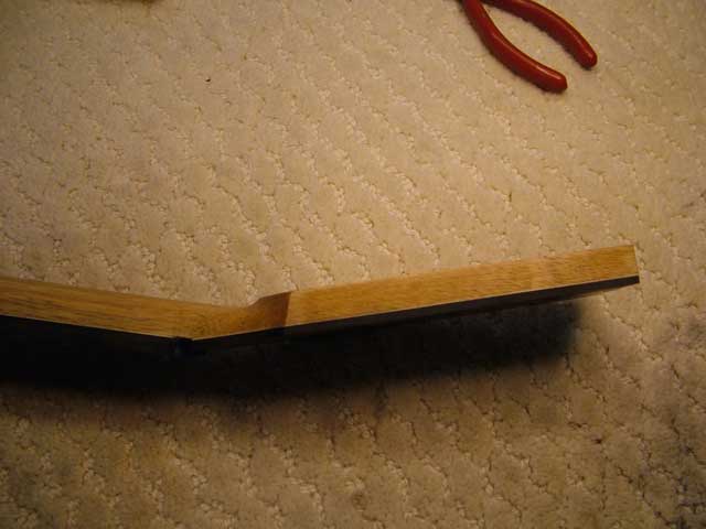

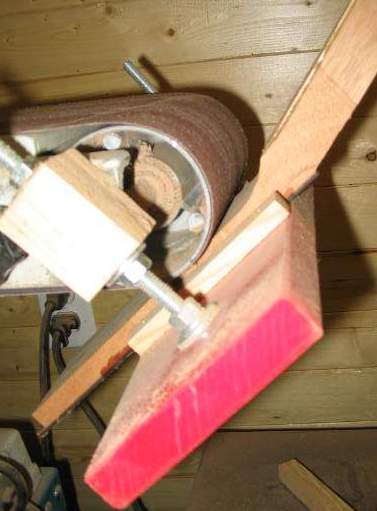

Here is my jig that I use to thickness the peghead and do the volute.
You carefully feed the neck in like this....
If that goes well then you glue the venere on and hopefully it looks like this...
That is how I do mine.
Josh

PostPosted: Mon Mar 28, 2005 1:30 pm
Looks like a good jig Josh. I think I'll see if I can adapt one for my belt sander. Thanks for sharing. You should consider adding this to the forum jig section.

PostPosted: Mon Mar 28, 2005 2:32 pm
Posts: 1595
State: ON
Well I’m not sure how much credit I can take for this jig. I took the idea from a jig I saw when taking my building course with Sergie de Jonge. I’m sure that with a little thought you could make this jig a lot more user friendly. Ideally I would have a small belt sander dedicated to this process that I could just leave set up all the time. But it will be a while before I have the money for those kind of extras. This jig has to be removed to change the belt which is a little bit of a pain. And it occasionally gets in the way when I want to do some carving on the sander. But I think this is the best idea I have seen for doing the volutes. However you must be carful with it. You can wreck a neck real fast if you tilt it into the sander. If you want more info on exactly what I do to get the back of the neck from start to finish or if you want some more pictures let me know.
Paul
